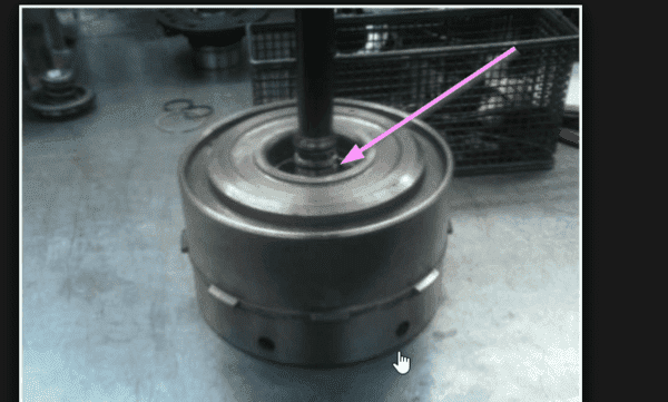

So i found a mid 70s 727 to scavenge from and grabbed the pump, input shaft and front 2 drums (can never remember which is the direct and forward) Just want to make sure that's all i need to convert to 24 spline? I don't think there is anything else worth swapping from the newer trans...
My other question is, in the pic beloew the drum the input shaft is in, on the 62 it a 3 friction, on the newer one it's a 4 friction, any reason to not swap it out? (The one with the little hand pointing, not the arrow... not my pic..)

I think you are good to use both Front and Rear clutch retainers with their original, matching pump assembly. I assume you will be inspecting and resealing every thing and don't forget to set the correct endplay to spec.

Yup, just ordered a full rebuild kit from A&A with thin frictions so i can fit more, and a billet rear servo piston.. last time i did a tf2 with a manual valve body that piston broke and it sucked.. rather not do it again :)
493Mike is correct. In your picture the forward is on the bottom. Forward describes function not location.
