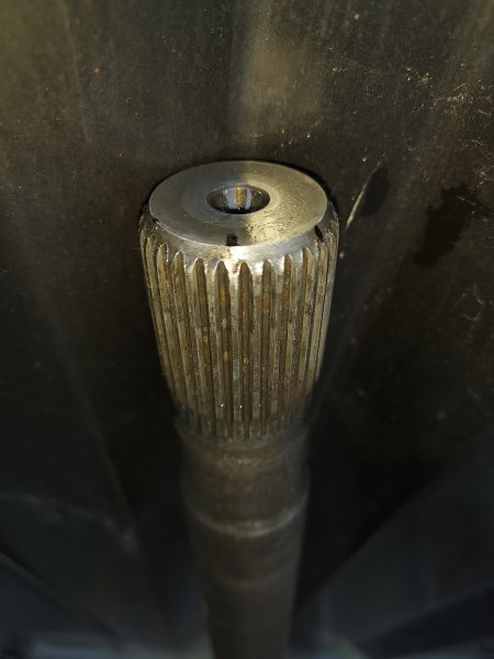

On my 69' Road Runner, equipped with an aftermarket or refurbished 742 8.3/4 Sure Grip, I have some play in the axelshafts. See on videos below. I wonder if it is normal, or if this could explain the strange noises I hear in the rear drive train under specific conditions (details below).
I confirm the axles can be rotated back and forth while the pinion (and crown) do not move. There is zero play in the longitudinal direction, or any other direction when shaking the axles.
According to the mechanic who worked on the car, it might be caused by worn out splines. Phenomenon is seen on both sides but seems more accentuated on passenger side.
The axleshafts seem original, beside this potential worn out splines they look ok, bearings are clean and must have been changed some time ago. (There are 30 splines on the internal side of the axles).

Those axle splines should be a close fit in the side gears. Second video of diff on bench.
Something is wrong in that differential or you have a mis-match of components.

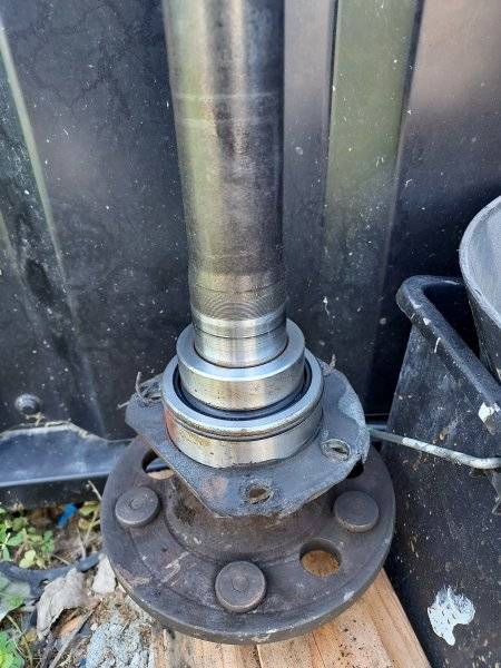

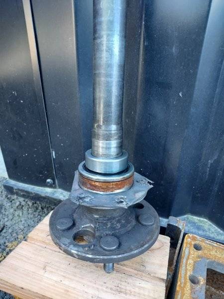

It has green bearings.. I wonder if someone forgot to remove the thrust buttons
Could be the thrust button left in and the carrier has been chewed out.
I would definitely pull that diff completely apart.
All the parts should fit "closely" together - axle spines in to side gear splines - side gears in to carrier.
I think the problem will be fairly obvious once you start to check stuff.
When I installed green bearings 20+ years ago in my 8 3/4 with 489 case and Detroit Locker with the large thrust button, I left it in because I didn't know any better. Years later when I swapped gears, the 2 halves were in the bottom of the diff housing. No damage was done.

I installed a set of the non-adjustable "Green" bearings when I restored my Satellite based on a friend's recommendation. The rest of the rear was, and still is, original - 742 case, 3.23 sure-grip. The rear end "clunked" when turning afterwards. The bearings started making noise at highway speeds after about 15 yrs and 15-20k miles so I went back to the factory setup - adjustable, tapered roller bearings - and all the rear end noise went away.
That's an old green bearing, no snap ring for a stop. Think that the thrust buttons should have been removed for those. The snap ring green bearings do not require them to be removed. Have three cars with snap ring type, buttons are still in.
From the technical diagrams I've seen, removing the thrust button would let the axle penetrate more deeply in the differential, is that right ? For what benefit ?

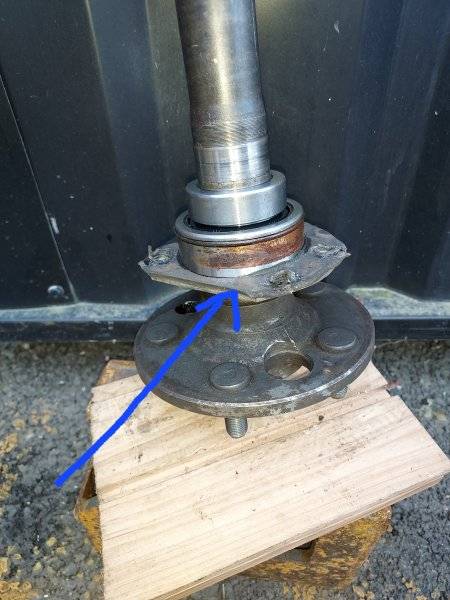

When we put the axle back in place, the axle could be pushed in until the plate shown on pic with the arrow reaches the axle housing. So, from that perspective, no "depth issue"
Well, the new greens have a stop snap ring on the bearing race, it sets the depth of how far the axle should go in.
Sort of right. Factory, the 2 axles butt up against the thrust buttons , and then one side is adjusted to the correct amount of play( clearance). So if you just jam in 2 non adjustable axles... how will you know if they are under pressure or not. You won't. Might get lucky, might not. If there is side pressure on the green bearing, that's what kills them . That style of ball bearing wants zero force on either side.
You don't know if the axles are butting together when you do the final torquing.
