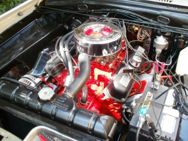

I must agree. To the OP, if you must build your 2 barrel 273 you can check out my 273 build thread on FABO. It's a stock build but to get to the 235 horse level what I did is what you need to do. You may want to stop over there, become a member, and check out all the 273 threads. Here's my Charger 273. (Charger was Dodge's name and Commando was Plymouth's name for the HP273.)
Build thread: http://www.forabodiesonly.com/mopar/threads/273-build.94343/#post-871687
I will be reading this over thoroughly. Thanks.
If the goal is to make a sleeper 4dr, put a bigger engine in it. The 273 is a good little plant. But it's for good little cars. A 4dr B body isn't that. You can get power from them. You will need to spend a lot of coin rebuilding it to get it compared to even a 440, but you can get 300+ from them. My advice would be to get a running 360 Magnum, stick a cam in it, stick a 4bbl on it, get the Magnum flex plate and cheapie headers and bolt it in. That should get you 325-350hp for under $1200. With a set of 3.91s and good tires that should get you close to your goal.
