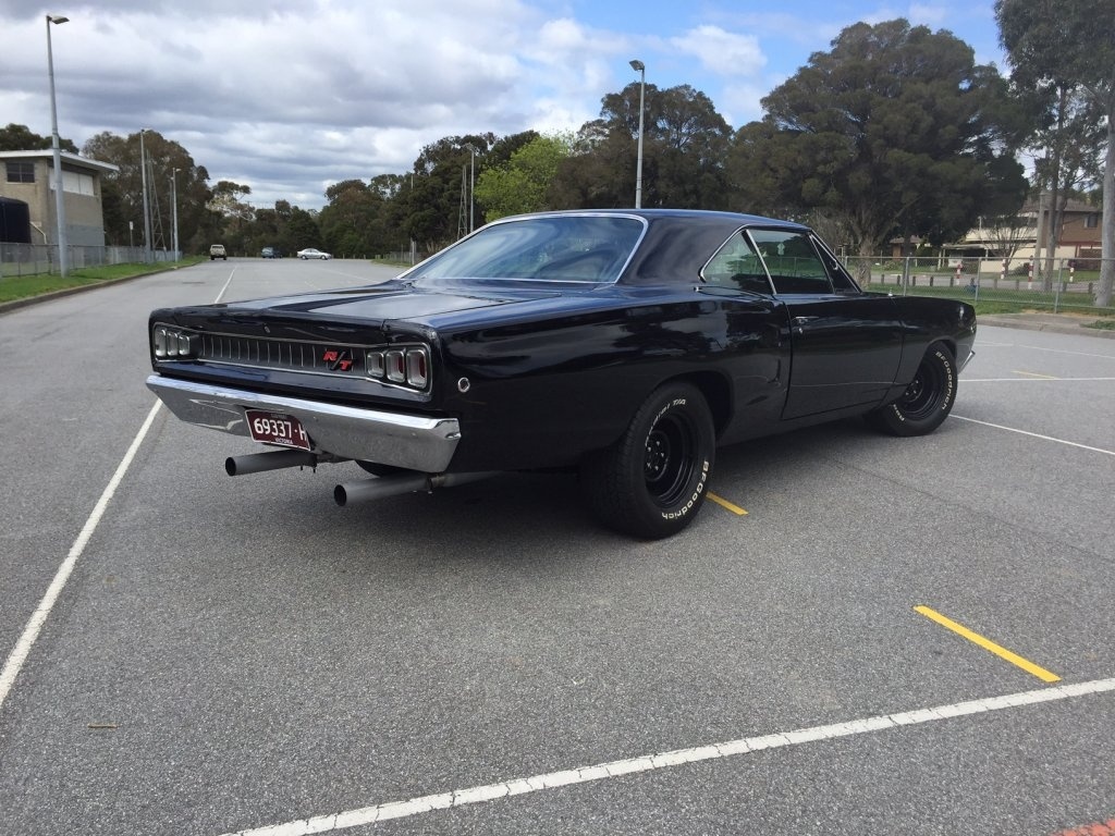

8" rim gives the caricature look that I prefer.
Same on mine atm, 275 on 8" 4" BS from memory. I'd like it to fill out the guard a bit more to be honest. Maybe 3.5" BS. I've gone 10"s for that reason & extra tread.
yup same rims at the front, but with 255's instead.
the 28" tyres look great for that tall rear period look. Just sucks that you can't get RWL in any wider than 275...
