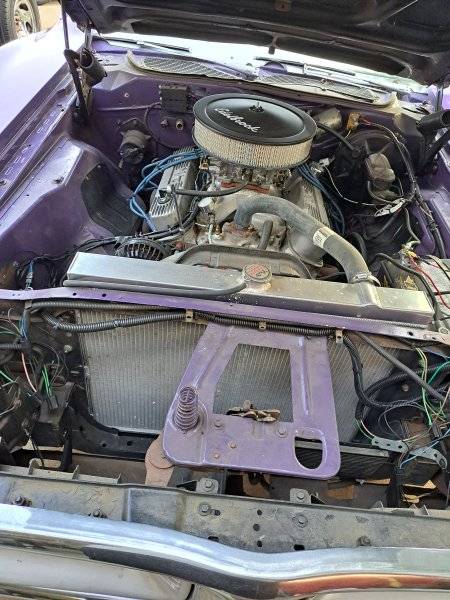

I'm not sure what everyone considers "hot" weather, but I see 120's on a regular where I live. 383/496 stroker, a/c, automatic. I went w an "Entropy" 26" 2 row of true 1.25" rows. Factory shroud w 19" 11 blade nylon direct drive fan. 176° at interstate speeds, 222° idling for 10 minutes w a/c on, 40° vent temps at idle, after 30 minute interstate drive. True 222° is still inside normal operating range. Don't know if Entropy is still out there or sell just radiator w/out e-fans. But my setup works in "HOT" weather.
