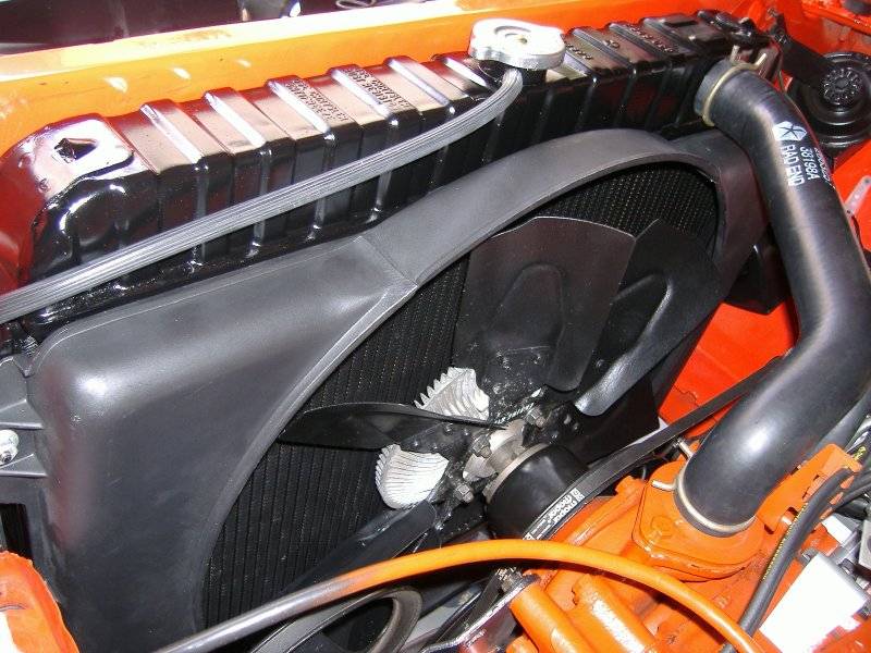

I had my "055" AC Radiator in my 440 '69 R/T recored from a 2 row core to a 3 row High efficiency core (more find/rows per square inch). Never overheated even on the hottest days. A shroud, the proper 7 blade clutch fan and good ignition timing also play a big part....
