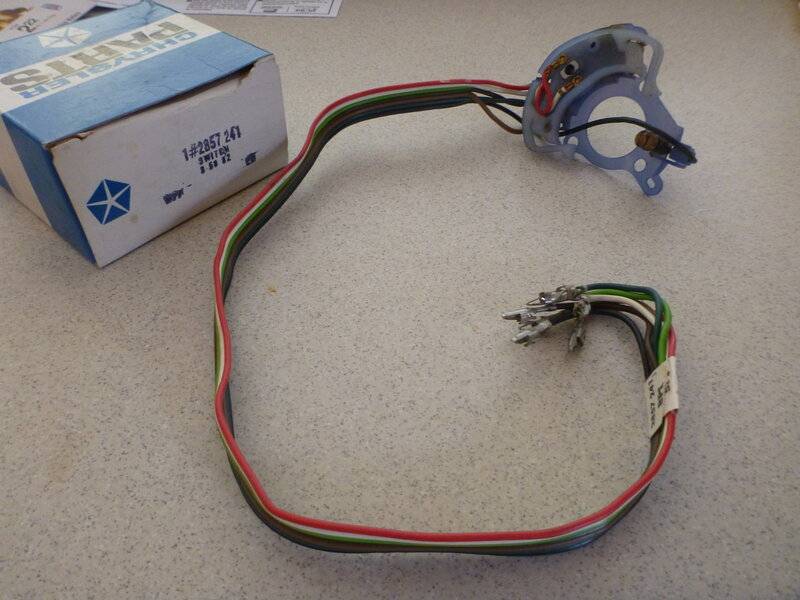

This morning I stopped at the local Chrysler dealership to get some numbers. The 2857241 was active up till 1992 if I remember correctly. Then there were a few superseded part numbers with the latest being 2947801 which was produced until 2008. I found one of those on eBay and bought it, about $100. less than the 2857241's. I'll post up what it is like when I get it. The one on Rock Auto is the Shee-mar that everybody is complaining about not lasting. I bought one from SlantSixDan (made in Argentina) because he says it is way better than the Shee-mar. I had used one of those only Bee, but must have forgot that it isn't the best either. The 2 brown wires as well as the 2 green wires are the same shade color and the switch is made totally different, so a guy can't compare the wires to the original. Also the one from Dan as well as the Shee-mar does not have the lane change feature that was standard on 1968 and newer vehicles.

I didn't ask them what the superseded #'s were between the original 2857241 and the latest 2947801 version, but probably the other ones you posted above are between there somewhere.
The 801 won't have a ribbon cable like the 241.. but in the grand scheme of things, who really cares. I saw that one on Ebay and was gonna send you the link and then our power went out this morning.

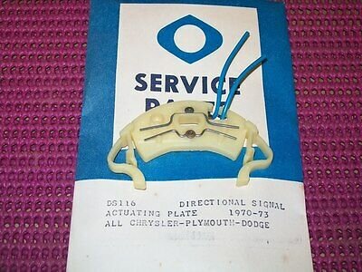

I bought the NOS repair kit for my Bee for about 10 bucks from AMS obsolete, as mine had a broken cancel ear. The solid steel "bridging" wires flipped out from under the retainer rivets after the 6th actuation...
..and yes what Joel is looking at (and the picture I showed last page) is the full assembly.

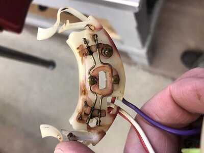

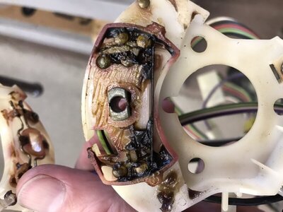

This is the AMS Obsolete part right? While it has what appears to be a Chrysler-related logo on the packaging it’s not an OEM piece in my opinion.

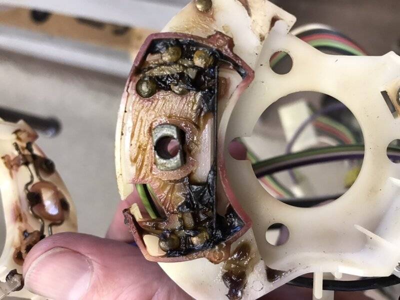

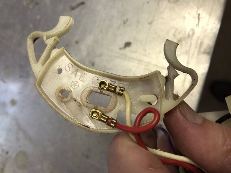

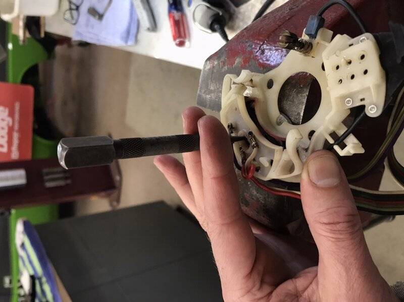

In my earlier post about the C-body switch, my suggestion is to harvest only that portion from the NOS switch. The one I bought is 100 percent the same as my original.
Here’s the c-body switch being disassembled.
12B02622-F6B0-4267-9148-5A535A6B0F37.jpeg 89F8C12E-CE2D-4860-B269-AFC47A93EAA6.jpeg F8BDE89F-0E2A-426C-A71F-14FF3C84A48A.jpeg FC69478E-1F61-4448-B626-AF9004F6A885.jpeg
Yes that is the one that fell apart after 6 actuations. It is also the part that is broken on most OE switches and why we need to replace them...
