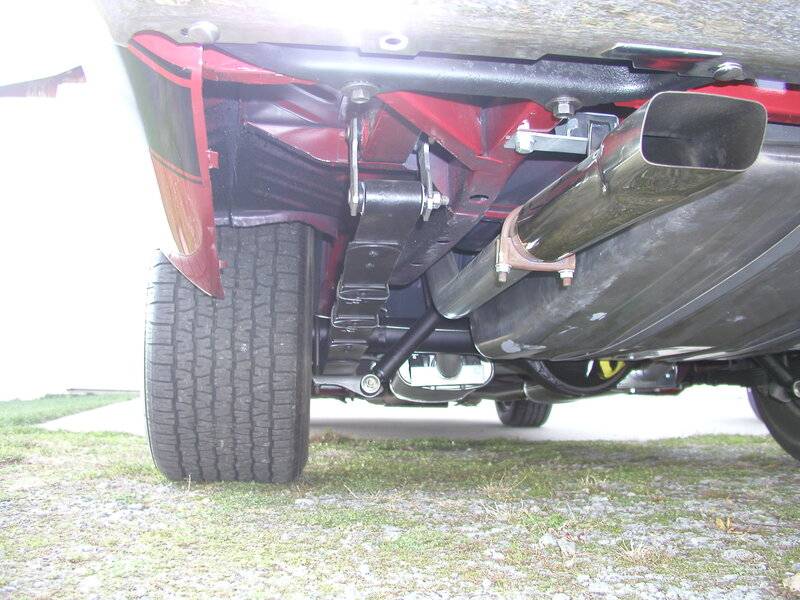

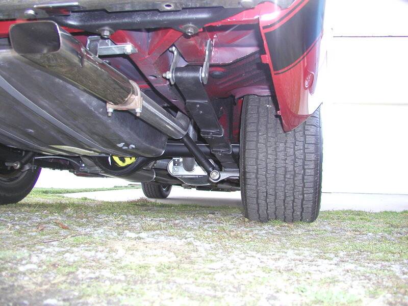

295/50-15 on a 10” wheel with 5” backspace
clears just fine on my 69” bee.

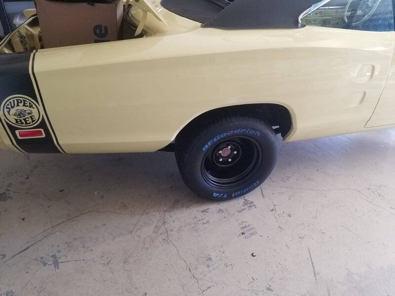

My 69 Coronet fits 30x10 slicks on 10" rims, 6.5" backspace I think. 3400lbs SS springs.
At one time I had 3800# on it and 3.5" backspace and that also fit because it sat higher. The suspension didn't work though because the car wasn't that heavy.
Total width would be over 12", those slicks have a really protruding sidewall.

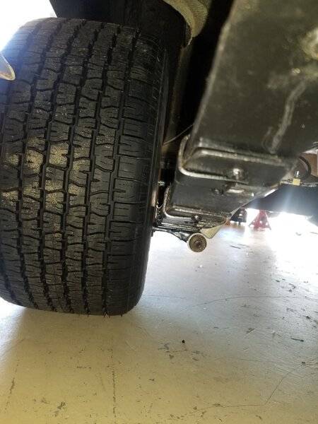

The 295s are .8" wider (the 20mm) so go under your car and see if you have room for an extra half inch inside and outside. If you do, the right wheel can get that tire on your car. If it would be too tight in either direction, you will have to adjust the wheel backspace.

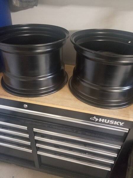

A 295 really needs to be on a ten inch rim. If your eights are centered well, and assuming a 4.5"backspace, you will need a 15x10 with 5.5" backspace
This is why you need to use the wheels and tires you have now, and a tape measure. So you know what you have 5o have for YOUR car.

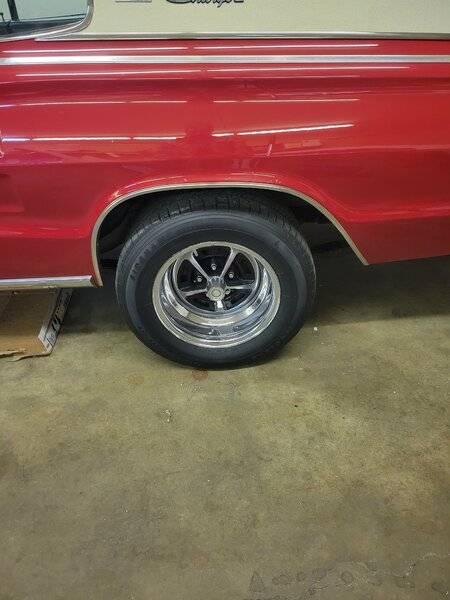

Measured my wheels perfectly.. the wheel guy welds them up and says "he added a bit because they'll rub on the outside.. he didn't know how wide a 67 charger can fit.. 295 50 on a 10.

I'm not familiar with the old 15x10 centerlines, about the only size centerline that I don't have, but the 15x8 1/2s came in 3 5/16 or 4 7/8 bs.
Unless your car had a full open wheelwell, the 4 7/8bs fit better.
Wait, I do have some 15x10 1/2 centerlines, but they were a custom, way back when. Shallow 15x8 front half, deep 15x14 back half. Ended up with 7 1/2" backspace, for moved springs, and an un-narrowed rear.
Get under there and get your own good measurements. One maker's 275/60 isn't quite the same size as another maker's 275/60. And you'll always find people on the web that say "it works for me" but they don't mention if they ever rub when turning, or if they trimmed the fender lip, etc....
