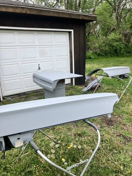

Been in 2k (unsanded) since last september, lost the weather to paint. Ill lay color end of May, hopefully.
