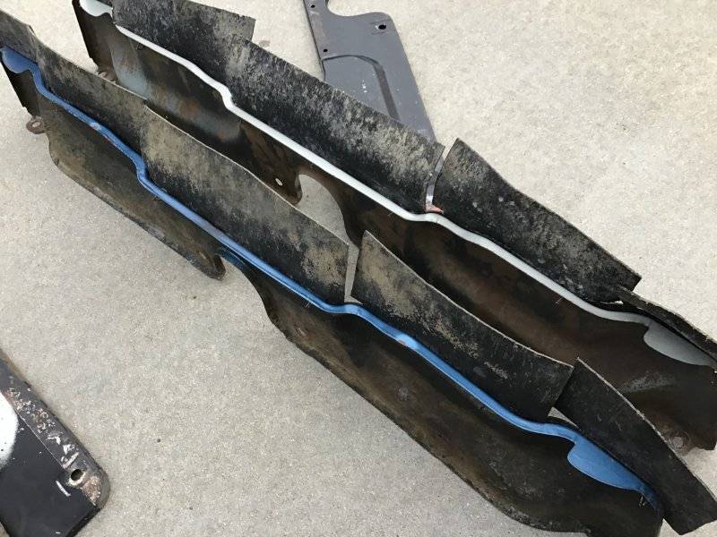

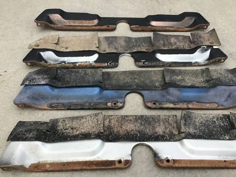

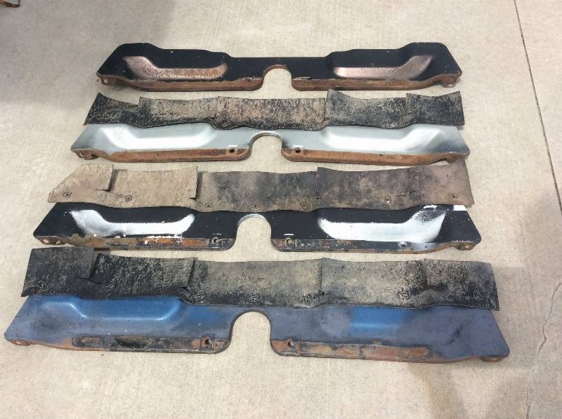

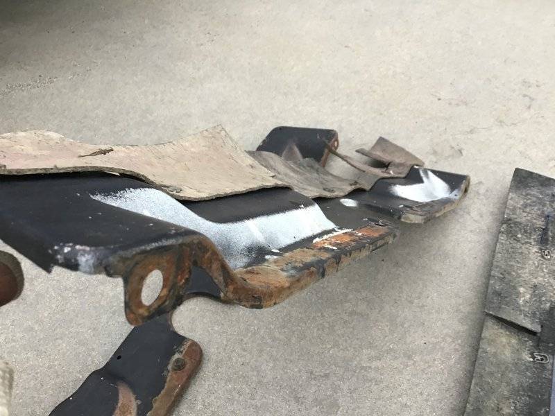

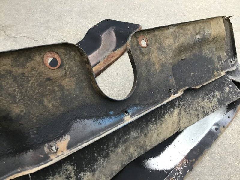

This panel bolts to the body and then got painted with the car. Then the core support blackout over the top. All 66-67 Belvedere. A guy was parting a 66 and a 67 cars both front bumpers gone and the body colored panels shown in the sun. Look where the attaching bolts were and no paint.
Most all other mopars these bolt to the bumper brackets and are black.
My 67 GTX semi survivor car is body color, but my 67 Coronet R/T survivor car is chassis black. Of the 4 67 Plymouth B bodies I have in this building, all are body color. The 66 Plymouth B bodies are all chassis black.

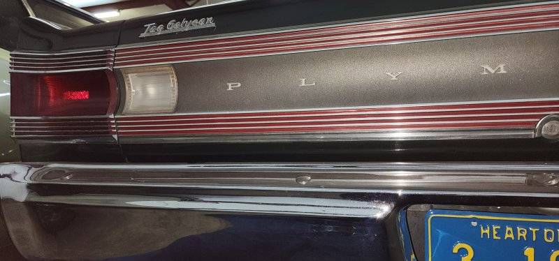

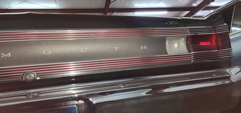

Jerry, I want to also ask you if you can send me a few pics of the tail light panel on your 67 X. I have seen slight variations in color in the Argent paint that the factory used and do not know what is the correct color.
When looking at this argent color, remember this car is 58 years old and there is probably some fading on this panel. It's had 91 thousand miles of exposure.

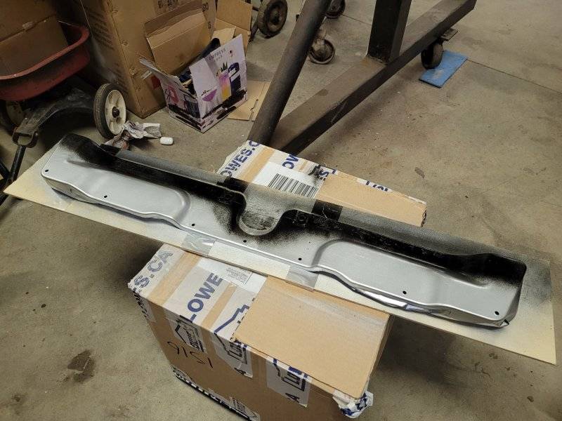

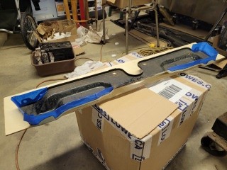

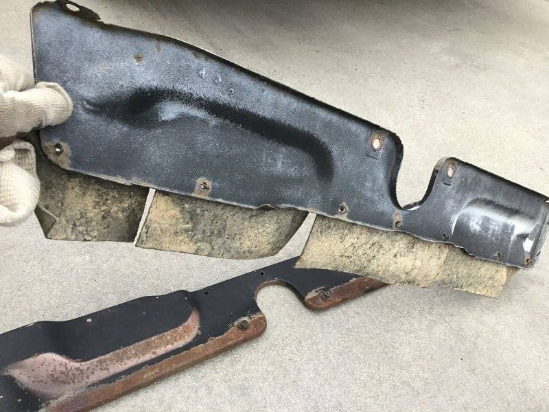

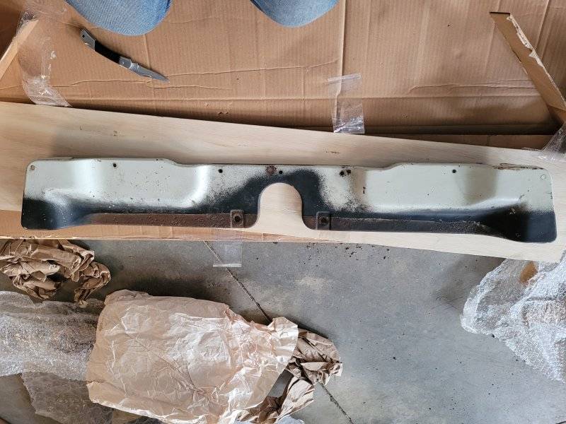

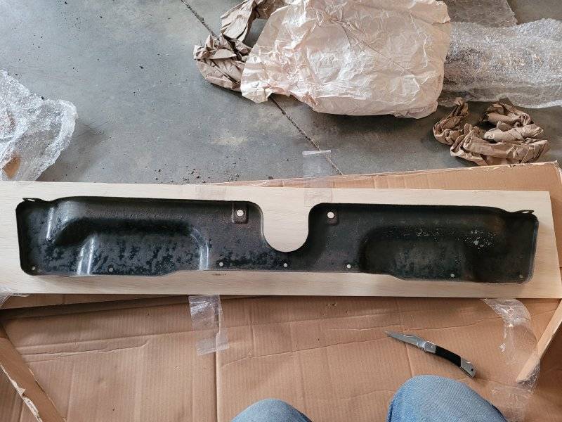

Body colour with the radiator support black out overspray on it... R413 schooled me on that long ago and I bought an OE accordingly and restored it.
As received (as removed non restored).

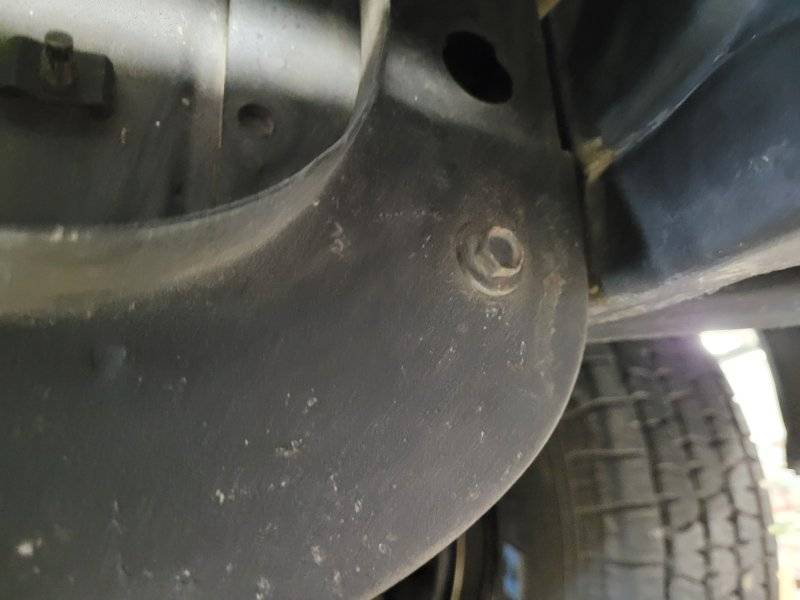

Repainted the Silver and Black, left the OE underside to match my 10,000 mile car and installed with new seals..

Thanks Dadsbee. Here is what I know. The body was dipped first in a black primer/ rust protectant. Then all body parts to get colored were added before they shot the color. Very car I ever seen had the color on the radiator cross member that the So e Deflectorwas mounted to. Yours seems to have all blackout. Not that it would t have some over spray on it. Whoever did this car got carried away, but they all do vary some. My car also had blackout behind bothe sides of the headlights as well. Which s tally does make sense. But I never saw it on another car.
View attachment 1939336View attachment 1939337

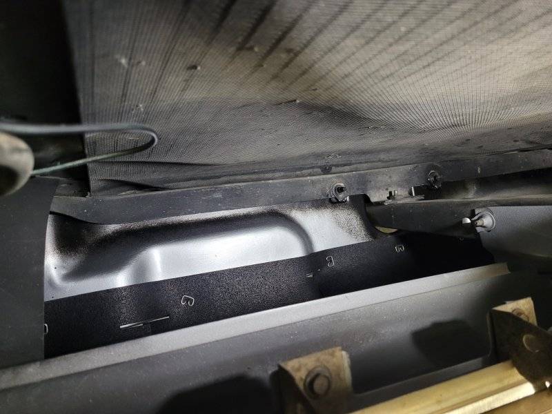

View attachment 1939338View attachment 1939339View attachment 1939340View attachment 1939341View attachment 1939342View attachment 1939343View attachment 1939344View attachment 1939345

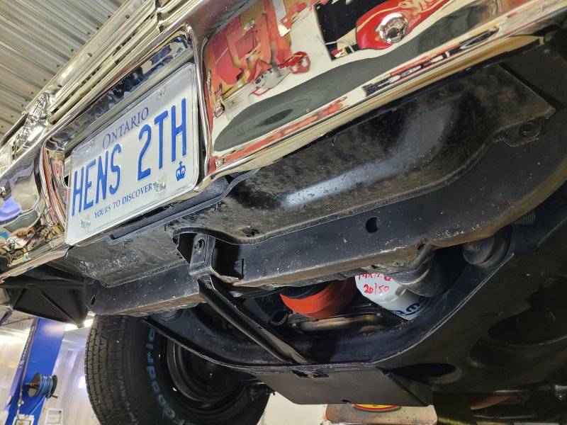

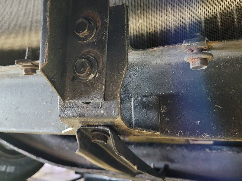

it appears that your center bracket that attaches to the K member runs thru the K member and bolts on to it, am I seeing that right? cause mine doesn't. is that car a 67 GTX?
was the bumper Y brackets on the car when they painted color? is any over spray on any cars that you know of?
The bumper assembly would have been installed after they fogged the front black. Then they would undercoat the inners.
All I can tell you is this is a 66 HP2, had 9706 miles on it when I got it. Nothing non- OE going on underneath.
I wonder if the 67 GTX was different? I hope so. Cause mine just butts up the front of the K member and screws in.
