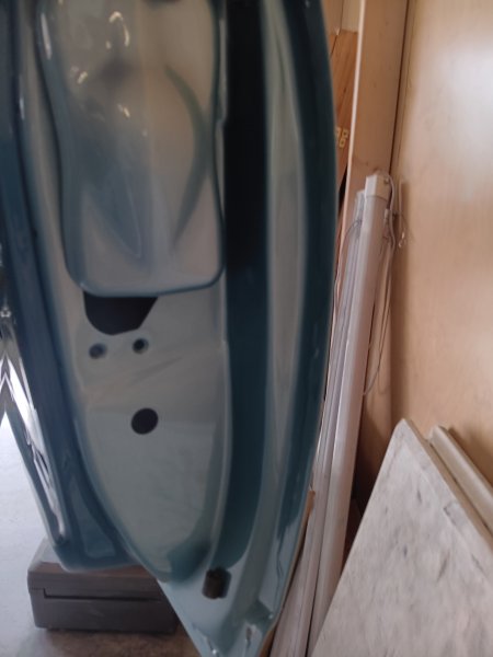

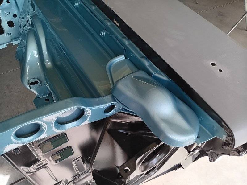

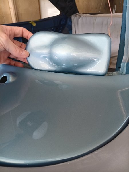

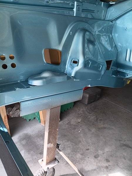

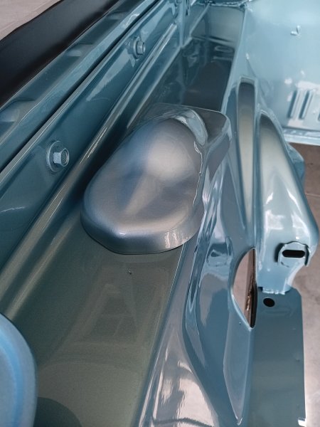

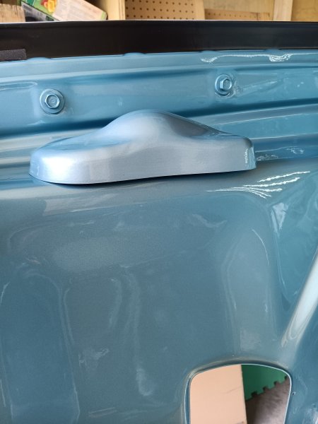

Couple comparison shots to the sample car. Sample car is two coats of spi epoxy, no 2k,( light scuff) 2 coats base , 2 coats clear.
Engine bay is 3 coats epoxy, 2 2k reg build, (sanded 180/320/400/) 1 coat sealer, 3 base with a drop coat, 3 clear
couple shots with the door too
Do auto paints tend to settle down/lighten slightly as they cure? I paint conversion varish primarily and they tend to lighten up some.
Quoted from the build thread, painters out there does time affect some of the pigment,for example lighten up. The little car is a couple years old. I understand different batches of mixed paint toners may be slightly different. Looking for some of the experiences you may have had with the paint after cure.
Never heard of that. Now, poor production clears will yellow or look tea colored over a short few years. Don't skimp on the clear coat. No Omni or Nason, at least for me.
