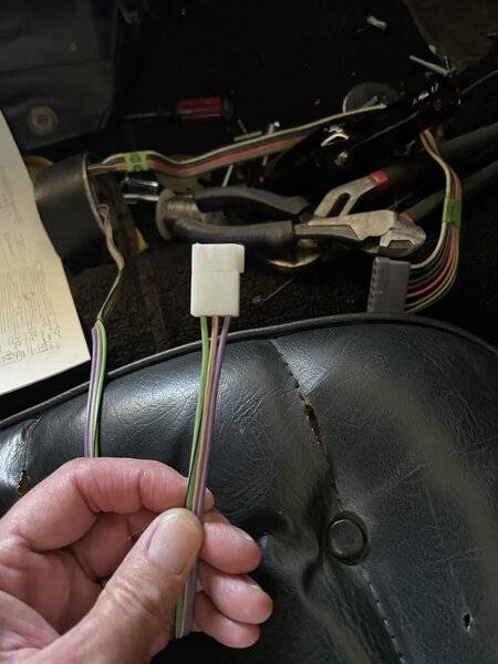

K guys I bought a 70 roadrunner, anyway the under dash harness was burned up and removed before I bought it. I got a new harness and started installing it. The turn signal module in the steering column has 2 connections coming off of it, the main 8 pin connector is good but there is a 3 pin connector that has nothing to connect to on the new dash harness. What is this for and do I need to worry about it
You have a C-body turn signal switch installed, the three-wire plug is for cornering lights. You can disregard that plug.
