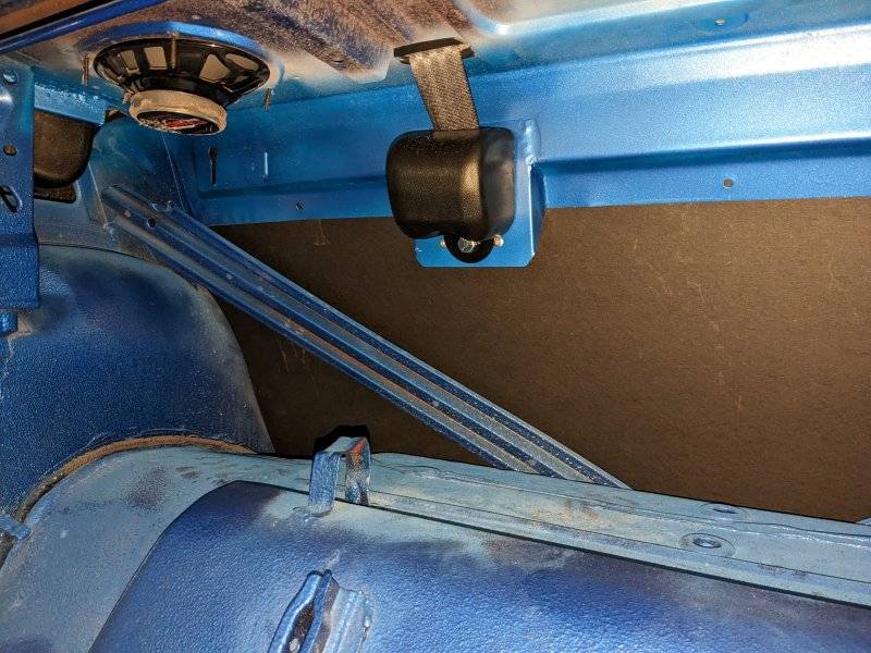

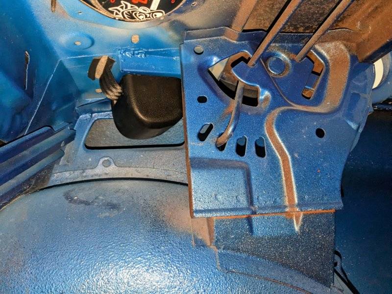

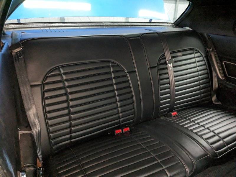

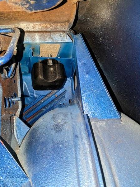

I just installed 3-point seatbelts in the rear of my '72. I got the assemblies from Wesco, but designed my own brackets. If anyone is interested I can give more information or share my bracket flat patterns.

I heavily considered using some modern Challenger take-outs for mine. The thing that stopped it for me was that some retractors have a secondary lock-out for if the car is upside down. Meaning, if you don't install the retractor in the exact same orientation as the original installation, it will lock up and not work.

Here is the link to the belts I ordered. There are a few options (color, buckle type). I asked them to reduce the buckle end to 4.5" since 12" would be too long.
Wesco Roadster seatbelts
I'll send you a PM with the flat patterns if it'll let me. Keep in mind that there are probably some differences between the 68 and 72. You may have to tweak the design.

Where did you get the trim pieces on the top of the rear deck that the seat belt goes through?
Those are from a late model Subaru. I found them on Ebay. You can still buy them new through a dealer though. There were a few other options that I considered, but those seemed like the best for what I was doing.
