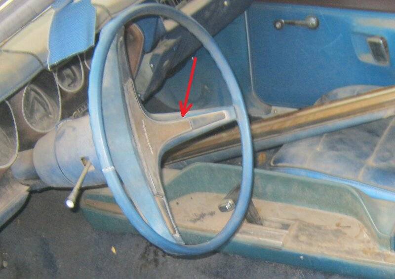

Okay here we go. Heat gun or a blow dryer and WD40. Start with one spoke and heat up the area by the red arrow in attached pic. I do this to warm up the plastic to make it less brittle. Then take a small screw driver or small prying tool and slowly pry up the tip of the cover. Lift it up high enough to spray some WD40 in there. WD40 with a snorkel straw is best. Let it penetrate for a bit then continue to pry and it should release. First spoke is the hardest.
So what you have is the heat for the plastic and the WD40 is for the metal. It still may fail you but you really up the odds doing it this way rather than diving with a screwdriver and going at it.
