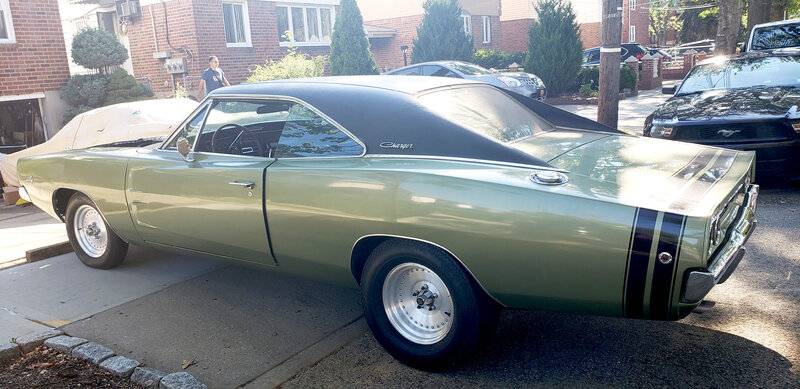

Im removing the centerline wheels from my car and going to Magnum 500s. Rear end has three inch studs. Should I remove the axles or just cut the studs or just leave the studs with the magnum 500s? What do you guys think. Dana 60
