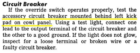

Can anyone let me know where the 30 amp circuit breaker is located on a 1966 Charger?
If you are referring to the breaker for headlamps, yes as Don states, behind kick panel on the driver side.
It is not in the service manual other than to say one exists, frankly the manual is pretty useless.
As Bob said, not much mention of it in the SM other than a few words here and there... Example.
