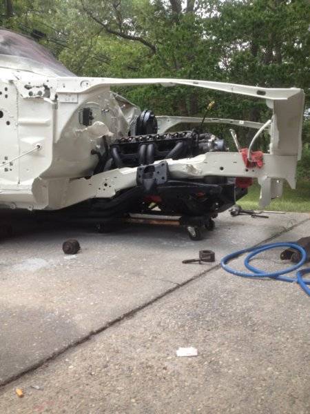

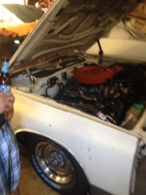

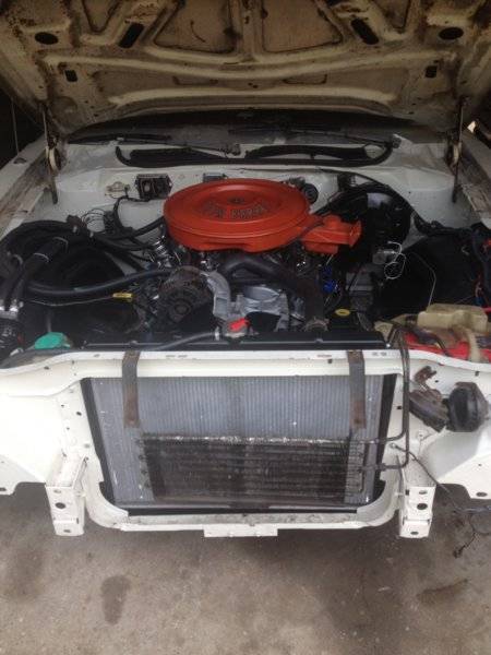

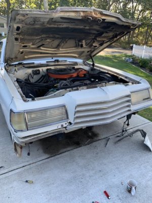

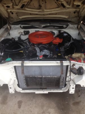

I did the swap in my ‘79 Dodge Magnum. I went up from a LA 318 to a 400 B block back to a 5.9. So the Shunacher engine mounts are used. I didn’t have the Magnums flex plate at the cranks end so I used a B&M flex plate. Otherwise, it went like this....
The OE P/S pump hose swapped onto the Magnums P/S pump.
I used Hooker 1-3/4 Super Comp headers. There expensive now but when I did the swap way back when, they were $330 to the door. They fit WAY better than the standard header does.
A Edelbrock RPM intake and 600 cfm carb was used, Lokar cables move the gas pedal and trans pressure lever. An LA distributor and MP Chrome box for ignition.
I used a Summit Racing exhaust kit. It is mislabeled and wrong but I made it work.
An Edelbrock electric fuel pump designed for the carbs lower pressure was used. Purchase the pump and wiring kit. There not sold together. Sorry I don’t have any detailed pictures on my phone but if ya want, I’ll take pictures for you.
