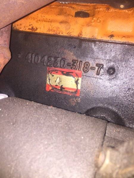

I was looking up the casting numbers on the 318 in my 74 Charger and found information on the net that ID'd the engine as a "race engine". Can anyone explain to me what that means?

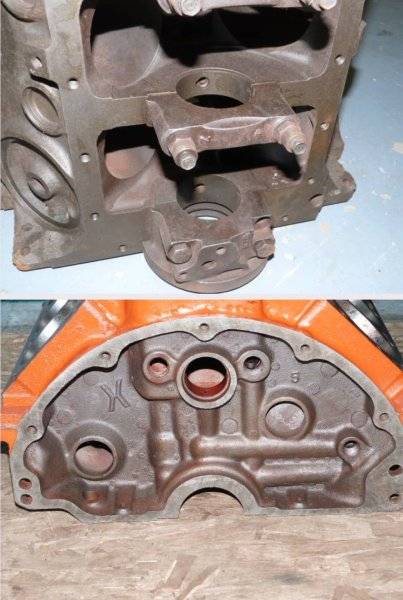

There is some info over on for a bodies only. If it has a x on it is a racing block. If it doesn't its likely a 81-83 run of the mill 318.
Also if you want to know more about what you have look for a vin on your block. If it has one it was not aftermarket, it was oem born in a car.

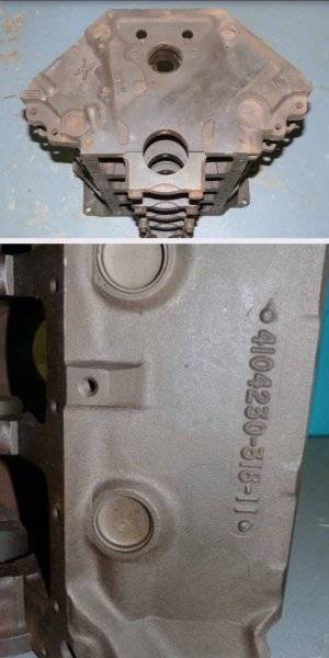

Apparently at the time when they made the racing x blocks the external casting was the same as the production 318, thus they share the same casting number 4104230-318.
But on the racing block the internal casting contains the differences with thicker webbing and thicker cylinder walls and also has a x. Saying the 4104230 is a casting number for a racing block is correct, but also a incomplete statement....it also should have the X.

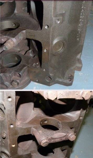

Notice the X cast in the Block. If no X its just a 318. The X block is supposedly up to 4.1 bore and considerably heavier. Check out the thick pan rails and main webs.

Over the counter direct connection. WAY heavier then a production block, supposedly 25lbs heavier. The confusion always is chrysler used the same casting number on the production blocks, just no X.
