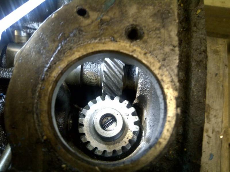

Correct. Rotor should point at same location old distributor was pointing when you removed it. If you didn't note that before you pulled it, rotate the engine to TDC and put the new distributor in with the rotor facing cylinder #1. Sometimes it's necessary to rotate the drive gear until the slot lines up where yo need it.
Here's what the gear and its slot looks like from above.

That's great news. I'm just so used to the drive gears being pinned to the distributor I almost had a mild breakdown when i saw the gear in the block. Thanks again guys!

Does it matter which way you rotate the gear? I've heard counterclockwise....
When replacing the distributor is actually BETTER to leave the gear in place: makes re-installation much easier. No reason to take it out unless you're inspecting for damage or wear.
The LA small block gears rotate ccw.

To remove the gear (should you need to) I take two big flat bladed screwdrivers and insert them both into the slot. When you squeeze the handles together, it sideloads the tips and you can then twist and simultaneously pull up the remove the gear. Reverse procedure to install. :icon_compress:

but still with intake, with just use a flat screwdriver to spin out in opposite direction of the gears theeth, will pull out the gear from the engaging, sitting it over the cam, and with regular long plyers will make the job to take it straight out.
