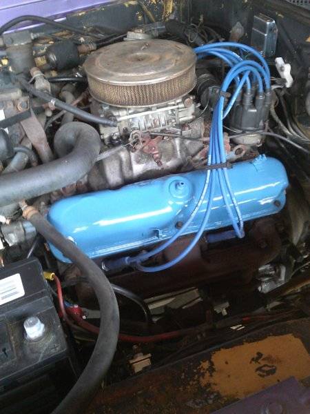

I bought a good battery. replaced the starter. I replaced the starter relay, voltage regulator and ballast resistor. I changed plugs and wires.
changed NSS..changed oil and filter..changed valve cover gaskets. Now I changed gas tank, fuel line and going to change fuel pump and filter tomorrow. I have ordered a new Eldelbrock performer 600cfm carb that will be here monday. Car turns over great but no spark to plug.
