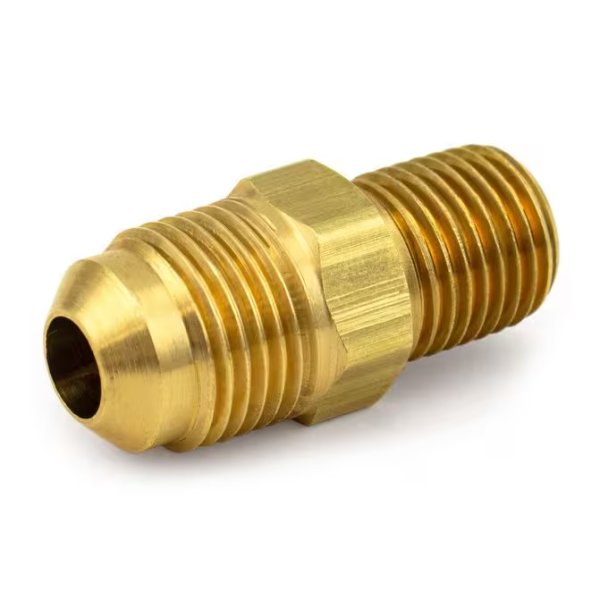

Use this as a bulkhead fitting. One side is pipe threads to accept a nut of some kind. You can get these in different sizes and the center drilled out if the wires are tight passing through.
Also seal it with a gas compatible sealer.
If you keep the pump in the tank.
If they come small enough to fit in 5/16” hole…. Would have to be tightened down on inside and outside of the tank, then fill it with seal-all and push the wires thru….
Something to think about
There’s a big variety of sizes.
As retired HVAC guy that’s where my search led me.
Just for information check Grainger, McMaster Carr and Home Depot online.
