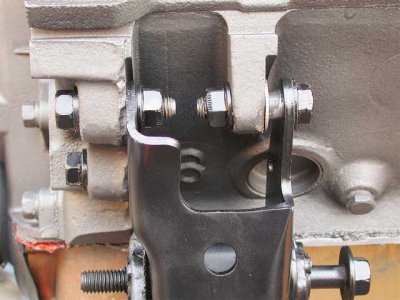

I'm assuming this is a pre Magnum 360. There's nothing the matter with using the 904. Plenty strong enough (will hold up in high 10 second cars). You will need to modify the left motor mount bracket (see pic). The 360 is externally balanced . Use this flex plate unless you have a factory 360 (pre magnum) converter.

That's all I ever did on my 318 to 360 swaps....use a spacer on the driver side bracket.
