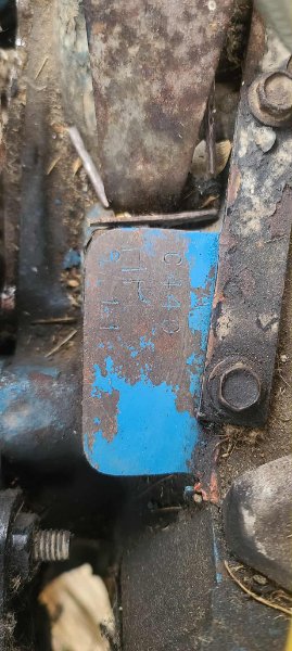

Finally got my hands on the car. It's a 440, but it's been "hopped" up so I'm told. He's a couple more pics of the engine.
Check to see what rear end is under your 69. Probably an 8.75 but could be an 8.25. The 66 should have an 8.75 which is a little narrower than the 67-70 rear. If yours already has an 8.75 than your good to go.
As Sam stated before, look for the pad on the block.
