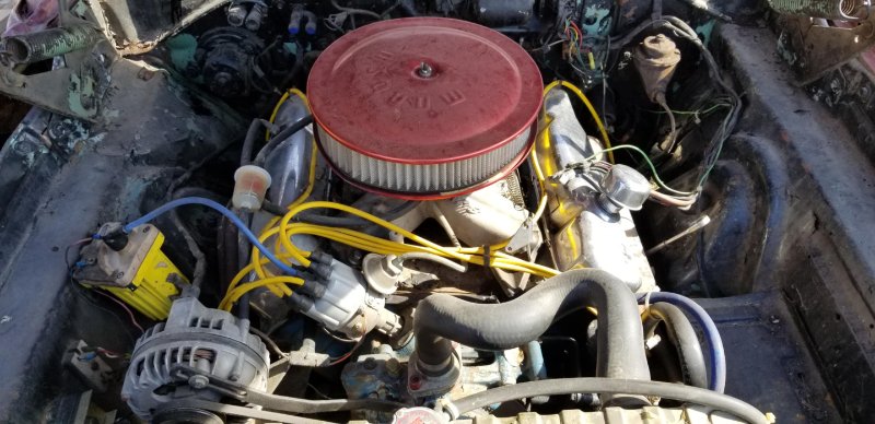

Thanks for the heads up. Is there a way I can find out which it really has? Not to sound like a jerk, but if by chance it's a 426, for the price I'm getting it for, I kinda don't want to let him know. LOL!! He sent me a picture of the engine. But I'm not enough of a gearhead to be able to tell the difference just by looking at it.

Well first of all, show us the picture. :) Is the distributor in the front or the back of the engine?
I can't say from that picture, might be a B and engine not an RB. (383 or 361)
Looks like a 5/8" return line on the power steering pump so it's possibly the original power steering pump.

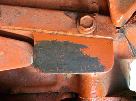

Ask if he can send you a photo of the 440 engine boss stamping. It's on top of the engine right in front of the intake.
Either way I'd be looking for a new engine harness.
I don't think you want to re-use that one.

As Sam stated before, look for the pad on the block.
Ok... so the car originally came with a 361. The 440 was swapped in. It has an 8.75 rear end with 3.23 gears. So that's all perfect. I can swap that over. It's likely my 318 has different gears.
