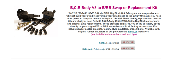

Car - 1968 Coronet 2dr Hardtop
Engine - Was a 318, but being replaced with a 440.
Does anyone sell these conversion brackets anymore? https://www.engine-swaps.com/Pages/ProductsType/EngConvKits.html
Any help with a source would be appreciated.
The motor mounts (the rubber inserts) are the same, small block and big block. What you need are the brackets on the engine. If you're engine doesn't have them I may have a set. PM of you need them. Mike
Those look like standard B/RB engine mounts. No idea why the seller is calling them small block conversion mounts.
Your 68 V8 K frame has the same mounting positions regardless of small block or big block. As long as you have correct 66-72 B/RB mounts you are OK. FYI - You will likely want increase your torsion bar size when you drop the 440 in.

Thanks. The torsion bars were next on my list to upgrade. Recommendations?
Your car likely has 0.88" dia bars. The 440 and hemi cars came stock with 0.92" dia. bars.
