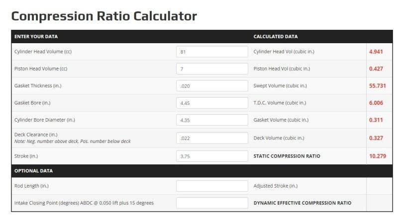

I need 915 head advice
The above motor has a.020 steel shim gasket and pistons are .020 in the hole, for a .040 quench. 10.2 compression with no ping
Bore is 4.35 Pistons are SRP

So you are using these pistons 213455 at 10.2:1 compression?

What cylinder pressure readings are you getting with the 10.2:1 and Mopar .528 cam?

Here are the figures I came up with: JE calculator seems high, used Compression Ratio Calculato
--------------------------------------------------------------------72cc 80cc 84cc -----------------------------------------
445​
4.350​
3.750​
6.768​
10.705​
2.062​
11.4​
10.5​
10.1​
-6cc​
690​
H
0.030​
