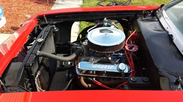

00D0D_4cNzzUxvZQr_600x450.jpgThe car is going onto a chassis dyno before I take it to the track in the coming weeks. Here is a picture of the engine. Needs some better wire management on the plug wires. But the little details will get worked out.
