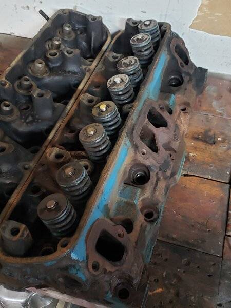

So took a pair of 587 heads i had on shelf to machine shop this weekend and no go.. so my question is have this fresh 360 short block 0.060 over, fresh 318 heads(pictured). how shitty will this thing run with the stock cam? can i run a mild cam with the 318 heads and stock springs or would that not even matter? i cant afford aluminum heads or any other expensive heads right now so i was thinking of just running the 360 as is till i can afford and swap later because my 318 is wore out...

I wouldn't use the 318 heads on a 360 for 2 reasons, small valves and small ports. those 2 issues can be fixed with a lot of porting and machine work but a lot of $$$ to make it so.
my 318 in the car is wore out and i want to drive my car, but my only options are these 318 heads or wait till who knows when for 360 heads
You could use them and they will work just not well. A lot of work just to make a engine run.

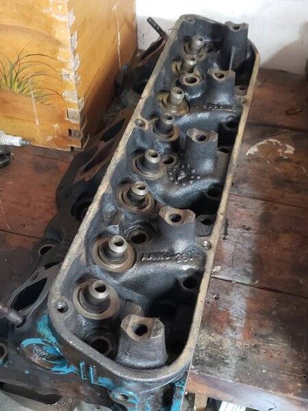

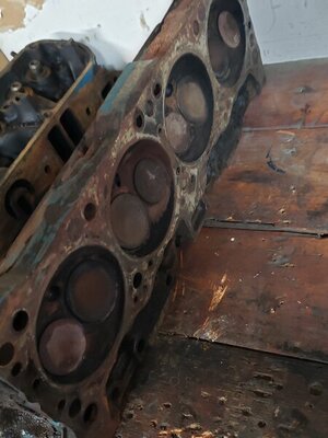

not cracked that i know of. i am almost determined to get some new valves, find some single springs that will work with my cam and just have them decked and go, but the exhaust guides i think might be worn and also they dont have hardened seats.

Those 360 heads should already have hardened seats, wasn’t 74 the first year for the 360?
I think I’m lucky and have an old sprint car guy that does my machine work for cheap. The last 360 I did had heads that looked that way. You can reuse springs and shim them. Valves a can be reused and cut as long as there not bent. Guides can be nurled in a pinch.
You need to find a machine shop that the dirt track guys use. They machine the crap out of everything just to keep racing the next weekend.

so you have a worn out low compression 360 and a fresh set of 318 heads
valves do not wiggle much and new stem seals
put them on and enjoy
you can save and do other heads later
