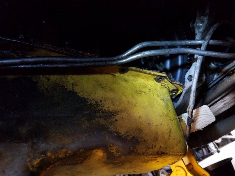

I'm throwing in the towel. From what I've read on this forum and a *73* manual I tried the following:
  • Dropped the center linkage
  • Turned the engine crank with a 1.25" socket
  • Disconnected the nearest exhaust pipe, even though the pan hits on the K member far before the exhaust pipe when trying to rotate the pan.
  • BFHammer
  • Removed the torque converter dust shield (which involved removing the starter)
  • Put the floor jack under the transmission housing to slightly lift the entire assembly
No matter what the K member and the front of the transmission housing is the limiting factor. I'm thinking of cleaning the mating surfaces as best I can and applying gasket maker and driving it to the shop but so much crap fell in already...

OK, take a deep breath, step back & take another look at it. I'm not there to see the problem (or your frustration), but just looking at your one picture, and reading your description, and hearing your frustration..... I would be inclined to take a Dremel cutoff wheel and cut the corner off the oil pan (with a big magnet, like a dial indicator magnetic base nearby to catch shavings)
Yes those corners are just catching by about 1/4". I'm fighting every temptation to jam a flat head to pry it down but that would seriously warp it. There's so much stuff I already disconnected/removed I think I'll try the Dremel approach. I have a magnetic hardware bowl that will fit the bill.
