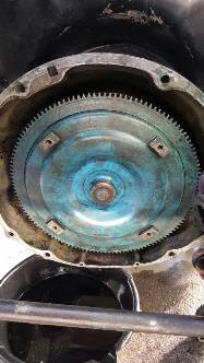

Here is what the converter looks like. I pulled it out and there were no weights anywhere, except for maybe there the bolt threads are.
I always had a vibration from 2000-3000 RPMS, and had a rough idle. Is it possible that the tranny shop put an unbalanced converter in?
I was told to just pry off the weights, where would the weights be?

No weighted flex plate. So based off the image you can determine that it's a neutral balance converter?

I'm sorry for the being stupid. But is that ^^^ a neutral balanced converter? Also, how can you tell?

If that converter was behind any 360, you would have had a vibration pretty much as you described. The weights are about 1/4" thick, sometimes in one piece, other times I've seen them in 2 but they are always about the same radius out as the mounting lugs for the flexplate. If this is how the trans shop put the car together I'd kick the manager in the ***.
Yes, that converter is neutral balance.

I put the 318 in without changing anything on the converter. I've never had my car drive so smooth.
After 3 years of driving the car with a bad converter. (I had the tranny +converter rebuilt by a shop, that solely does trannys.) I figured they'd know how to balance it, and never thought it to be the converter.
