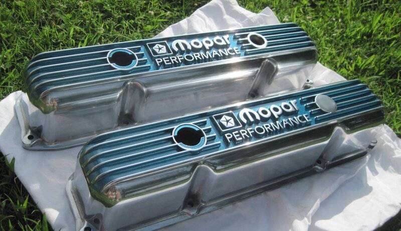

Watching this thread and you give me hope for my ‘68 383 build someday to come! Some of the bling already bought for it! Edelbrock Performer manfold and Edelbrock Performer 4 barrel carburetor.

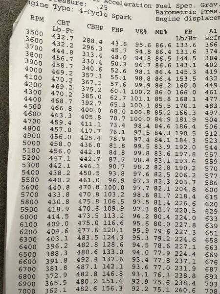

They respond to all the usual hot rod stuff just like anything else.
Good heads, good induction, headers, cam, compression, quench....... they like it all.
This one got all that...... went in a 70 Challenger street car, ran on pump gas:
Thanks for all the replies!
Thanks @PRHeads for the dyno sheet.
Looks like a nicely balanced combo of torque and horsepower, and I love the 7k RPMs. Would it be accurate to say a properly built 383 "likes" RPMs to make power? What I mean by that is, is the bore to stroke ratio a fundamentally good ratio to inherently make power up high and handle the piston speed? What I mean by that, for example, is although my 440 is larger displacement than my wife's Pontiac 421 (now 428 @ a .035 overbore) the Pontiac's bore to stroke ratio actually makes for an engine design that has a higher piston speed at any RPM, thus it isn't a "naturally" high winding motor.
