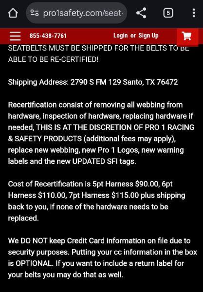

Pro 1 Racing & Safety Products
This is a good company to get seat belts from. You can send in your expired Pro1 belts and get them re-certified. They are high quality seat belts made in the USA.

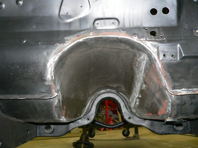

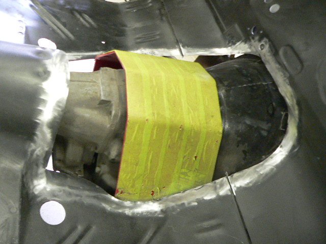

The two items that were a great help for access was pushing the firewall back and enlarging the trans tunnel. The firewall goes back pretty easy with a bottle jack and some wood across the the front of the firewall. The bottle jack on the K frame and a 4x4 betweeen the jack and firewall board. Move a little and move the board around. The tunnel enlargement makes using the standard TCI aluminum trans shield a breeze. Cut the hole at the front abouut 2" larger. Leave the rear of the tunnel at the trans crossmember and the throttle pedal mounting area. Then shove an oversized piece of sheet metal up in the hole. After tack welding (start at the top and work down). Trim the excess and finish weld. You cage looks nice.
Doug
I’m inserting DVW’s outline from another thread in here so he doesn’t have to go over it again. I think it’s pertinent to this conversation as well.
Doug, I have a full front floor pan available to me from the other clip I have. I’m thinking of cutting mine out, splitting it down the middle and welding each half back in place approx. 2” outboard from its original location. Then using a strip from the donor clip to fill the approx. 4” void created down the middle. I should also be able to raise the tunnel slightly, massaging the sheetmetal to achieve that. Thoughts?
Can you offer more detail on the firewall mod. Sounds to me like simply once the tunnel is cut, the firewall just gets bent back in the middle in a controlled manner (??). Attachment at the A-pillar areas is unchanged, correct? And how much are we talking here? I suppose even just 1/2” would give back the thickness of the motorplate, so you could essentially now move the entire engine & trans rearward that 3/8” or even a scosh more….. until we consider the transmission mount at the crossmember. Any magic tricks to share there?

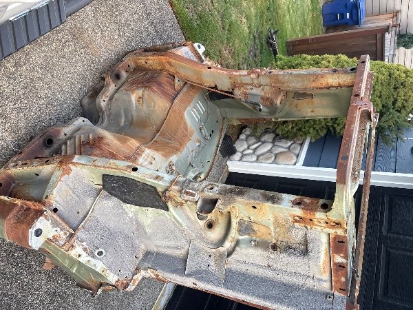

Donor sheetmetal:
The firewall will bend even with the floor pan attached. Depends on how far you want to go. Mine kinked slightly but was and easy repair befor paint. I like you ides with the trans tunnel.
Doug
