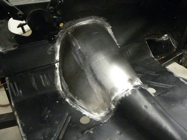

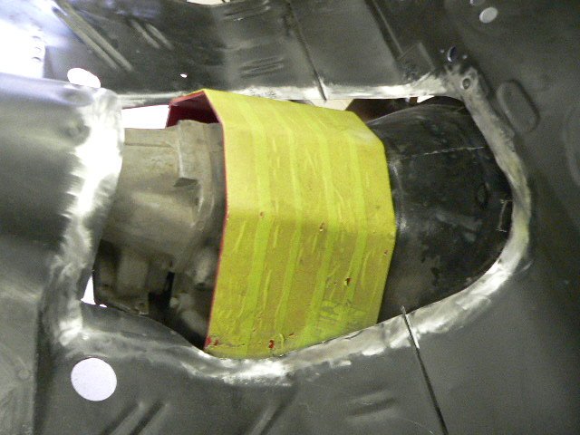

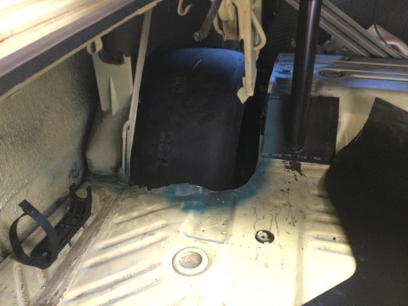

Same here just as DVW. Scratched built the trans tunnel out of found metal out of a metal shop in the Navy Yard. bent it over some barrels and hammered it into shape to clear the engine and trans setback.
LW might have an opportunity to really get some good weight distribution not only with weight loss itself, but moving the drivetrain rearward.

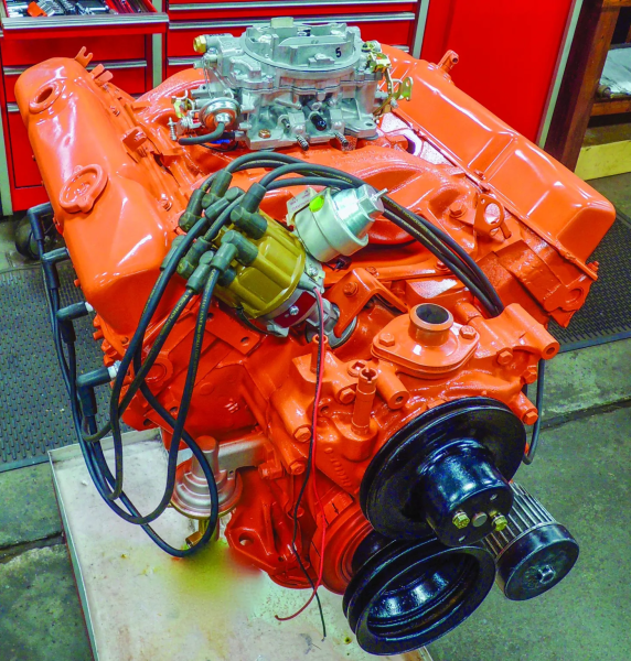

I moved my mill back almost 4" inches. Short driveshaft now.
