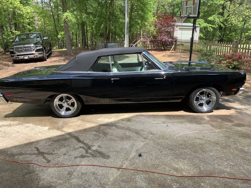

Welcome from NJ. Got any pics of said RR?
Here’s a few pictures

Welcome from Alabama, great looking Runner.

Nice RR
