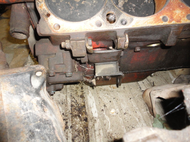

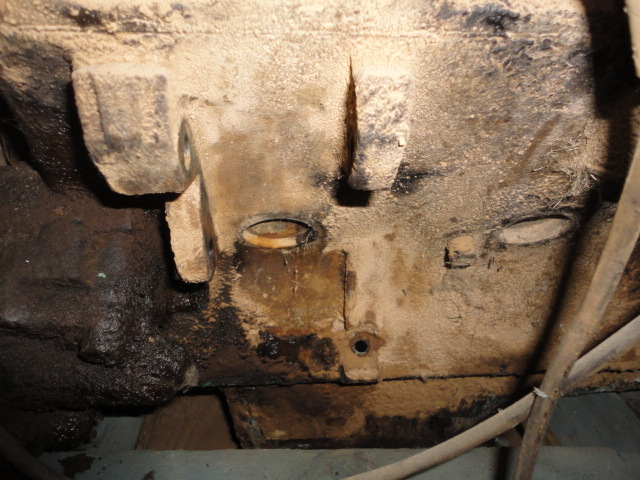

If you buy it would you please post a picture of the block? Just interested in the mounting locations mentioned by monaco66coupe.
also,
my 68' 383 A body is numbers matching, but Chrysler didn't stamp those engines HP to my knowledge. So if it is stamped and a 69, look for a VIN to see if it isn't really a B body. I'll try to get a picture of mine and post the mounting.
383 A engine mounts

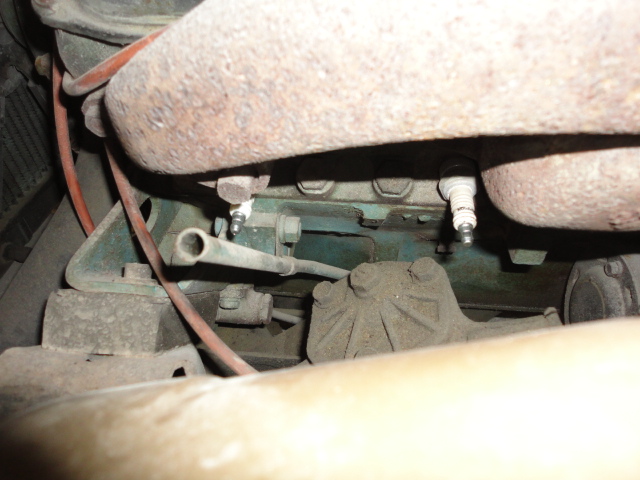

here are pictures of the 383 A engine, and All other 383 engines. A engine is first, and the Car. 27 sept 2015 383 A and  B engine mounts 006.JPG27 sept 2015 383 A and  B engine mounts 003.JPG27 sept 2015 383 A and  B engine mounts 002.JPG26aug 14 GTS is home 015.JPG
In the first picture the exhaust bolt configuration at #1 looks different or is it just the picture?
yes it's just an extra from the rear where the exhaust manifold is deeper. normally a short stud and nut.
