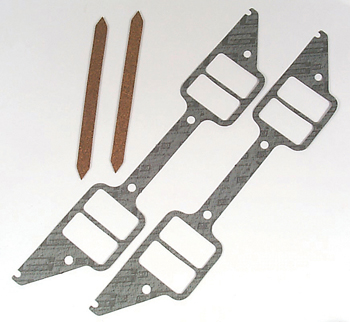

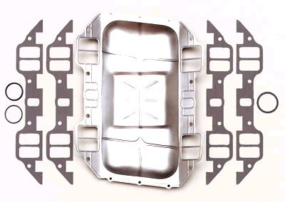

like they said :iamwithstupid: , also or even a thin Gasket on-top of the valley pan gasket, is acceptable/even necessary sometimes....

heating and cooling even cast iron parts many times will cause warpage.perfectly normal.as said before,torque to spec should take care of that bit of a twist.you shouldnt need the paper backing gaskets,but a bit of sealer is always a good idea.

Keep in mind you are likely not going to get an extra gasket in there but with only .005" gap you won't need it.
