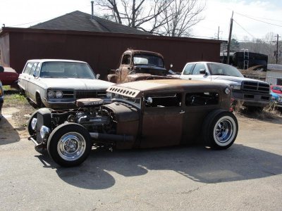

Here is Charles' two rat rods. His 29 Model A (which now has a 392 Hemi instead of the 403 Olds), and Jeepers Creepers which has a dual quad 383. Charles built them both from the ground up. They are somethin else.
