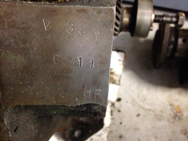

I have a 64 383 that has the HP on the pad below the distributor.See attached photo photo (2).JPG
Very good, as anyone can see, HP stamps were utilized prior to the 68' model year. 64's were some beautiful cars!

The engine is still in the car I was planning on getting the old girl running before I started tearing anything apart. 66satellite your stamping is laid out just like all the other ones I've seen while trying to figure this out. Mine is laid out different. I can't post pics on here but follow the link and you'll see what I mean. What did the HP stand for in 64?

The "HP" is for High Performance. "V" is for 1964. Yours certainly is different. the "VV" could just be that it was double stamped and the "C" could be for a special crank and pistons but I don't know for sure.
