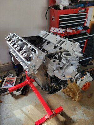

I'm looking for any tips on the next steps of my 383 refresh from you guys with experience. I just received my 440Source heads and they are about to go off to the machine shop for a good once over and a milling. My short block is 40 over with KB162 pistons that are .027 below deck. Block was checked, crank was polished and rotating assembly balanced..etc by a machine shop. My cam is a hydraulic flat tappet comp xe274h, Duration 274/286, Lift .488/.491. A different machine shop will be going over the heads for me as I wasn't quite happy with the shop that did my short block. I have fel-pro 1009 head gaskets with a compressed thickness of .039. I still need a rocker arm set and pushrods. Im leaning towards just the stamped rockers (its not a race car). I have a push rod length tool though. Can I just tell the machine shop that I want these heads to be at 75cc combustion chamber? Should I do any piston to valve clearance checking before I request that volume? Can i go more? I need to get as much as i can milled from the heads due to the pistons not being at zero deck. The KB162's have a decent valve notch. Any advice would be greatly appreciated!

I had some basic requests when I had the short block redone. I was limited in my budget and selection of pistons a year ago when the machine shop had the short block. I assumed the shop would use the measurements (compression height etc) to deck the block. That didn't happen. The engine was assembled and I was left with those pistons in the hole .027. I'm just trying to make due with what I have, and move forward. I would def like to be above 9 to 1 compression. One of my requests to the machine shop a year and a half ago was atleast 9.5 to compression.

Normally I would agree 100% about pulling the short block apart. This is my first time going through an engine rebuild. A machine shop had my block for 8 months. He assembled the rotating assembly without zero decking the block to the kb162 pistons. When he called me to let me know it was assembled, it was going to be another 3 to 400 bucks to pull it apart and reassemble, another 200 or so to deck the block. I was so fed up with communication and the time frame I said forget it and went and picked it up. Being a newbie, it was a lesson learned. I have since found another machine shop to do my heads. I talked to him about taking this short block apart, but that starts the process all over again. He wants to re-measure everything since he didn't build it. And that's understandable. So I'm cutting my losses basically, going to mill the heads down to 75cc and enjoy it..
