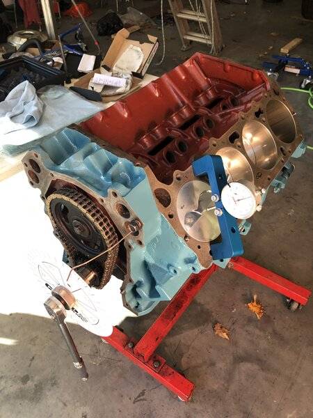

Agree with Stanton here. I am currently helping a friend with a 440 source stroker 383/438" with their Stealth heads. After researching every last detail and pricing everything out including machine shop costs, I can say with 100% confidence the money would have been the same or more if he chose to recondition the stock parts.
We also saved money by assembling it in my shop so that may or may not be something you will need to consider. Besides hot tanking, initial measuring then boring and honing the block to final size, the machine shop installed new cam bearings, freeze plugs and a distributor bushing but that was really it. The final bill was under $850. We did not have to deck the block or have the mains align honed.
We have gone through all the blueprinting procedures ourselves that would have really added up if we had paid someone to do it - deburring and painting the block, file fitting the rings, installing the pistons on the rods, degreeing the cam, etc.
Our block was bored .060" over. Most likely your block will need to be honed if not bored over so no matter what, you are into the project for that operation plus the cost of pistons, rings, bearings and balancing. Reconditioning the stock rods would have cost us more than the new 440Source rods for $250. We were quoted $750-800 to recondition the stock 906 heads which made zero sense. Why sink that much into old, iron heads when you can buy modern, better performing aluminum heads for $1,000?
There really is no downside to going the stroker route - you get 55 more cubic inches with all new parts, lighter pistons, modern heads etc. We chose a mild hydraulic cam so it will be easy to live with. This motor should make 425-450hp pretty easily and will make a ton of torque. The 438" is still a shorter stroke so it should rev like a 383. Paint it factory colors, throw a 383 pie tin on the air cleaner and no one will ever know what's inside.

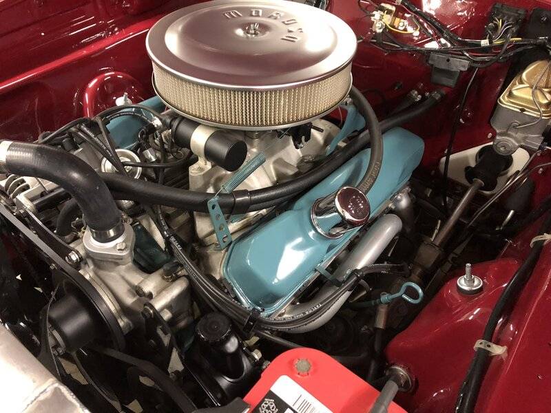

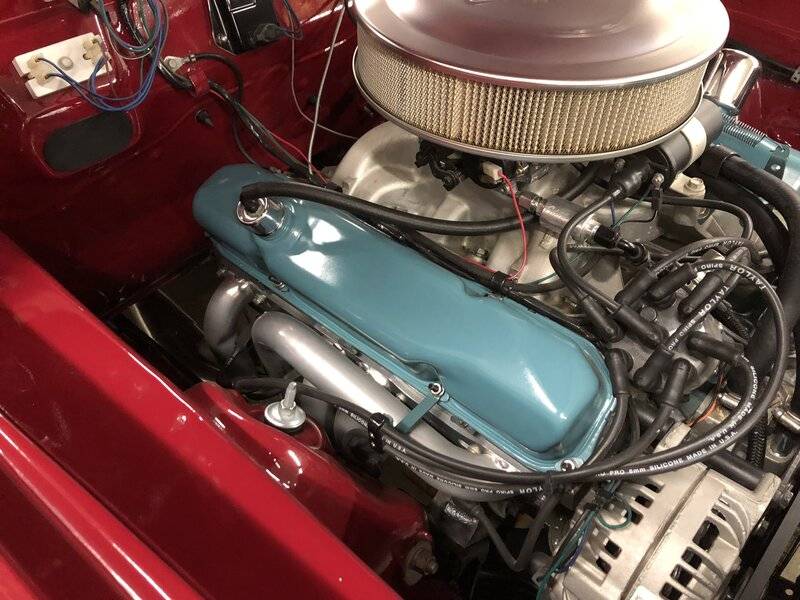

For my 65 Belvedere I used a 69 383 block bored .030 over with an Eagle 3.9 in. stroke crank, Eagle 6.760 H-beam rods, J&E pistons for a 9.8 to 1 CR. 448 cubic inches. Comp XE274 cam, Edelbrock 84cc heads, Edelbrock Performer RPM intake, Edelbrock 800 cfm Thunder series carb, Chrysler electronic ignition, TTI headers and exhaust system. It’s hooked to a Tremec TKO600 transmission with an 8 3/4 3:55 rear gear. I really like this combination, it pulls like a much bigger engine, but it wasn’t cheap. It’s a low deck engine, so I didn’t need to cut a hole in the hood for clearance.
