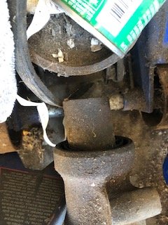

It "seems" like the transmission itself is OK except for the piece of the driveshaft yoke stuck inside the tail housing. The transmission turns & seems to shift fine (by hand out of the car).
