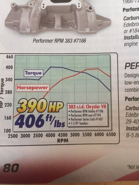

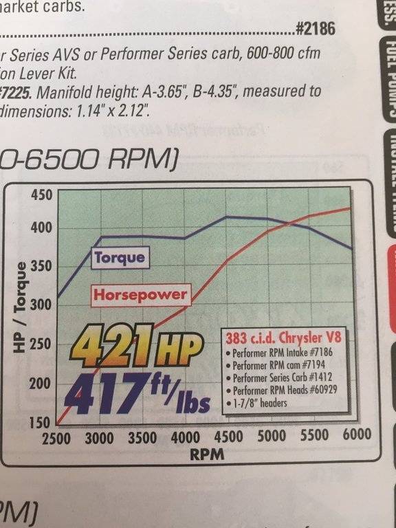

From the 2009 catolog, no (Edelbrock) aftermarket cylinder head in use.
The differences are, heads AND a switch from a 1407 carb to a 1412 carb.
(1407) A Performer 750 manual choke to a
(1412) Performer EPS 800 manual choke.
It comes out to about 360hp at the crank. A base rebuilt 383 (not running custom pistons and not blueprinted) would have been anywhere depending on the parts used, the machining done, and the quality of the tuning. The RPM heads could have issues if they were never gone trough before installation. So it could be realistic. So could a stingy dyno, bad convertor, etc... Take it to a track, get it weighed, and get some runs in on it. Than do the math. Then you KNOW.
