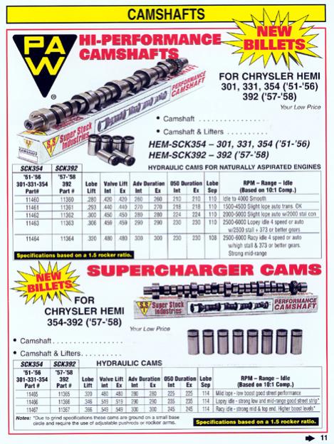

I run the 11363 cam from PAW below its 290 duration advertised and 230 a .050 it is healthy for the street my 392 runs great with 2x4 carbs and 2800 stall convertor and 3:50x1 rear and behind a turbo 400 trans. It has a lopey idle but idles pretty nice.
