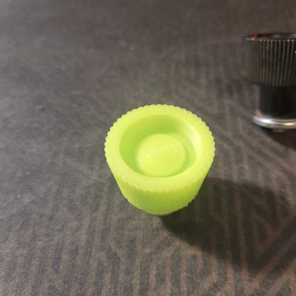

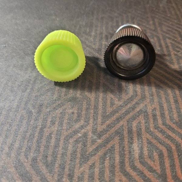

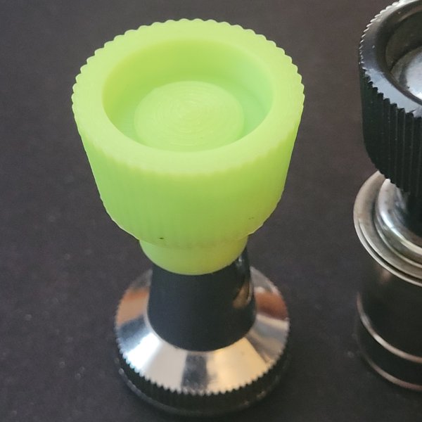

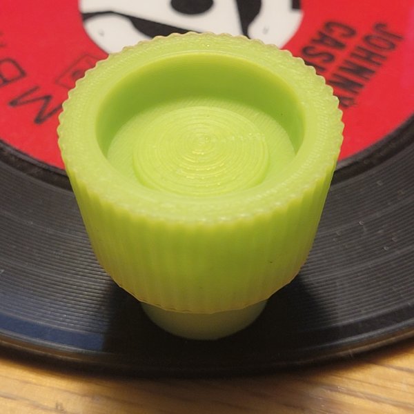

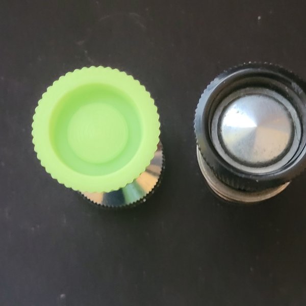

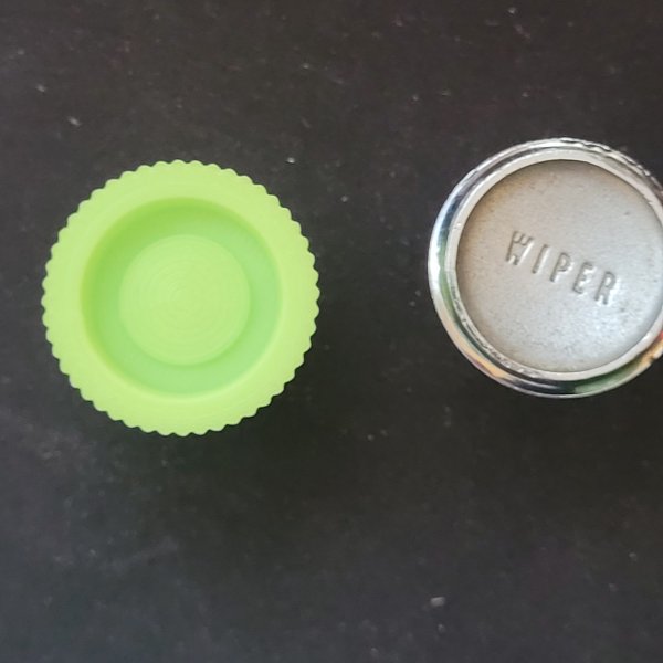

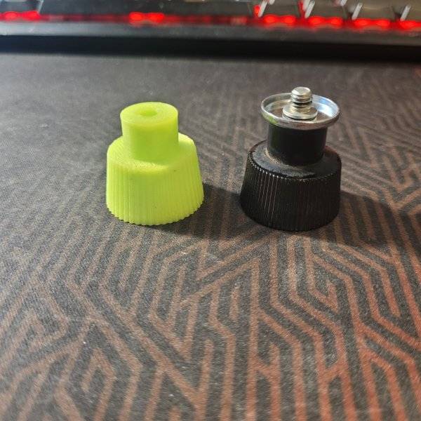

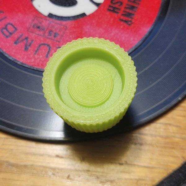

Being the cheapskate that I am, an not too picky, I decided that I would like to try to match some radio knobs to the factory ones in the dash (turns out my wiper knob is missing, as is my radio and knobs). Taking some photos, bad measurements (ruler/eyeball), I tried my hand at Fusion 360 to create a 3d model which I then exported for my 3d printer. Making the knurls was a little tricky and I didn't know how detailed my printer would go (and I was still learning how to use the software), I went with bigger knurls (48 around vs 72 on the original). It's slightly thicker and taller at the top (where it would get grabbed), again, because I'd rather err on it being sturdy than thin and break. I don't know if the inner chrome piece will fit (it might, its close) but I didn't use a micrometer...

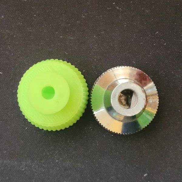

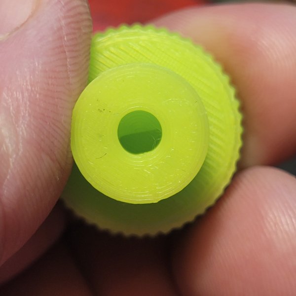

I also read online about radio post diameters: 3/16 inch shaft with a half-flat, which seems to be smaller than the wiper opening but I'm going to check it on an old am radio from another car and see. Next iteration will make sure the hole is right. I wouls also use finer settings on the printer (0.2 mm print layer, vs 0.16 mm) but I wanted to see if it would be close first.
Anyhow, when and if I refine it, I'll post back.

looks great, I've made a few different parts with my 3D printer for my Charger. What did you print that that in ? PLA ???
I C that you are from Canada as well . I know temps out in Alberta usually aren't not to crazy. But remember that if you used PLA, it starts to soften at around 60c. The inside of car can get to that pretty easy in a hot day. maybe look into printing in PETG?
For a small part like that. I would have printed it on my resin printer. The detail you can get with one of those is just crazy.

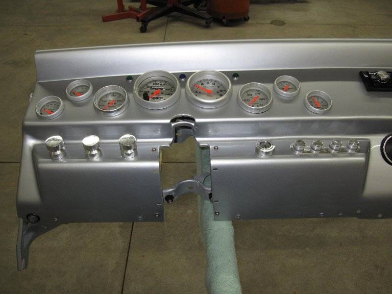

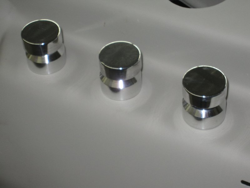

I'm old school so, I made knobs on my lathe from aluminum to match the control knobs from Vintage Air. I really do think 3-d printing is cool!
Mike
You could use a disc sander to put that cone on the end of aluminum round stock of the proper diameter. Polish it and cut it off. Glue it in the center.

Yeah, in PLA as proof of concept. I know someone with a resin printer so might hit them up once I've got it dialed in.

I have my printer working on another prototype for my gauge cluster right now in PETG, previous was in PLA and I left it laying on top of the dash and even in winter sun it got soft. If the PETG is still not up to it then sending the files to a place like PCBway for printing in ABS is an option. Fusion360 annoys me so I usually just use tinkercad which is free and made for learning. I recommend it to anyone interested in 3D printing, plus you can also do electronic circuit design there and simulate power to them.
I did try tinkercad a while back and forgot about it this time around. I use the free version of Fusion 360 and it seems overwhelming at times. I have read that pla is not the right material for vehicles due to the distortion factor in heat, I'd be interested to know if PETG works.
Well PTEG does not seem to work well with my printer, new nozzle and everything and the extrusion was on the flimsy side, similar to when I've had a clogged nozzle in the past. It was good enough to verify my design is almost perfect tho, so from here I can either outsource and get it in ABS, or use what I printed as a template and cut an ABS sheet. I want to maintain the plastic look of that era which is why I'm not messing with metal yet.
