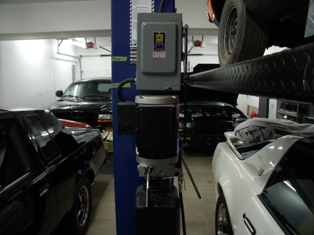

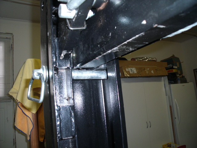

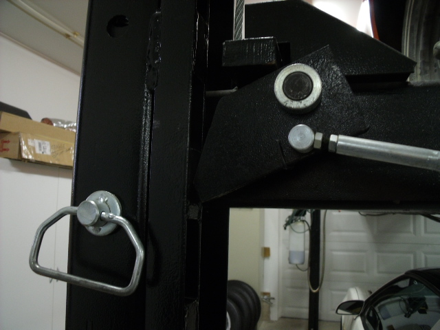

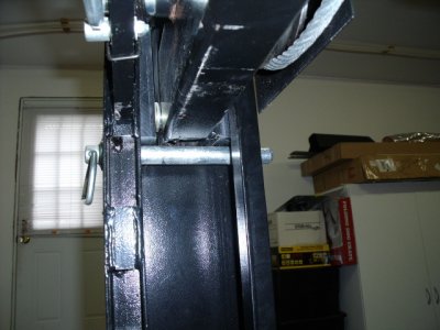

I have a Prokar 4 post(Chinese) that I bought in 08,they since have redisgned the lock system to a "lock ladder" type setup.I personaly don't care for it as the ladder is basically hung off the top plate on the column.My 2008 lift has lugs welded to the column and the lock levers sit on those.NTM,being a nervous nelly,the position I store a car at,I drilled 3/4" holes thru the columns directly below the crossbars and have 3/4" pins thru them as a just in case as one replied a lock broke.If one did,it can only stop on my pins.Otherwise the lift has been fine.A backyard buddy 4 post is $5k,I know American made,etc,etc,but that's a lot of cash,NTM,Mohawks.Do your homework,go see one in person to see if it meets your satisfaction of how it was built.Thats what I did with the Prokar,skeptical on the "Chinese" made product,once I saw it in person I was satisfied on how it was built,and how it locks on the columns.I also have a Bendpak 2 post,which is great,also as one said about being Chinese made,half correct.The columns and arms are made in their own factory in china that all that is made there IS Benpak.The chains,cylinders,pump and motor are made in USA.Then I also have a mid rise scissor lift from Rotary line called Revolution,that is their offshore model,but again,thats all that's made in that factory .They have to be sure and stand by that product as well as it is affiliated with the name Rotary.

Good idea from ee2 avr on adding safety pins.
(are those the ones used for the castor kit)
I noticed the inside opening on the columns would also
accept 2x4 or 4x4's cut to length for a backup system
You will see thousands more Bendpaks vs. BYB in hobbiests garages,and more than that in commercial applications.If you do as much research of Bendpak like I did when buying my 2 post lift,they put extreme engineering,research,testing,etc into their product compared to BYB.Bendpak is a very large corporation now and as I said about Rotary having their offshore brand now called "Revolution",also don't want to risk making an infearier product that could hurt them in the long run.When I was buying my midrise scissor lift,I physically drove to NH to Greg Smith to see with my own eyes the Atlas brand they carry,chinese.Then when I went to a Rotary dealer to see the Revolution scissor lift,bar none!!!!! The Revolution blows it away in cylinder size,lock system,and the structure was way more beefier.It cost me about $700 more to get the Revolution,but feel it was worth it.As far as Eagle lifts,from my research,they are exactly the same Chinese model as my Prokar,as dozens more are.They are the ones referred to as all being built in the same Chinese factory.If you look very close they are exactly the same,just dif colors,names,stickers.Heres a story for you,just this weekend I went to a guys shop that had the exact same 4 post as mine,and when I looked over at it,with a car on top and one underneath,the locks weren't engaged !!!!!!I asked him how the heck is that being held up?He said,he just raised it up and left it.You mean it's sitting up against the cylinder only being held up by the pressure in the line to the pump motor? YES.No that is nuts/crazy/and plain stupid.He said its been like that now for 3 years !!!!!That also means that kind of weight on the cables as well.Again,myself being nervous nelly,I drilled thru my columns and sent 3/4'' pins thru and that is what the runways/crossbars and weight of car is sitting on instead of the factory locks.Therefore,no way it can ever come down.I did this partially because of my ceiling height being only 10' and with the car on top,it just won't make it over the last lock point before the roof of car would hit the ceiling,so I raise it up past the holes,install all four pins and let it down on them.Also,on my 2 post Bend Pak,I put a switch box right above the pump as a failsafe if the switch ever went bad and the car kept going up,I can right there kill the power.
pics...

Well said !!!!And,again,you can see my extra precaution with the pins !!!!
