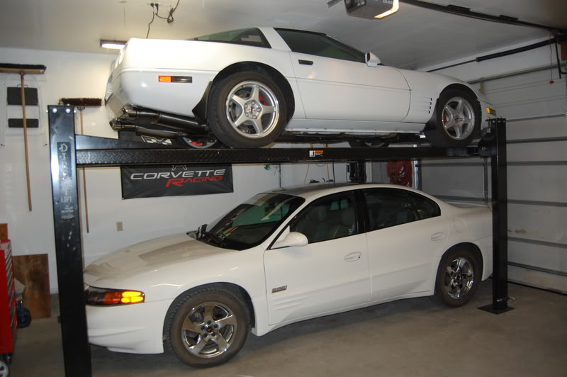

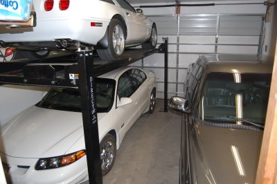

I have a Direct-lift Pro-Park 8 Plus. I have had it for over 5 years. The only issue I had with it was the hydraulic cylinder started seeping. I had the cylinder rebuilt and it's working just fine. I've had my pickup (Chevy Silverado) up on it many times but mainly I use it to store my Corvette. I turned my 2 car garage into a three car.

Mine is 72" to the top of the runways. They offer an extended height version as well. The runners are about 5" thick. My garage is 10'1" at the house end and it slopes to the door to 10'3". My Corvette is 46 1/2", so I can put the lift as high as it will go and I can pull the car under. My pickup is just about 4" too tall.
If you are going to have 14', the only way to go would be the extended height version.

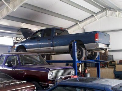

I researched them before I finally got the Bend Pack HD-9XW This was one that I could actually fit my truck on, and not break the bank.
I have had the lift for 4 years and haven't had any problems with it.
