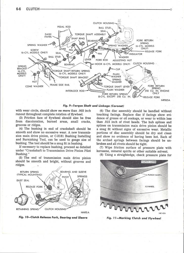

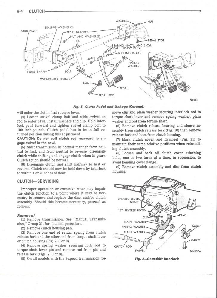

If you have a diaphragm clutch, that could be the problem. I had to install a spring on my pedal to bring it all of the way up when I had to go to a diaphragm clutch from the original Borg & Beck. Here is the adjustment procedure from a 69 Service Manual:
