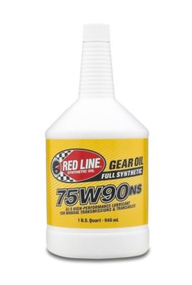

The Latest Japanese stick shift lube specs are one way to start
another is to Use RedLine or other full synthetic lube that is marked for manual trans
Some trans mfg use ATF and all kinds of lubes
not for your Mopar
finding a lube where the trans and rear end share lube is more of a challange
