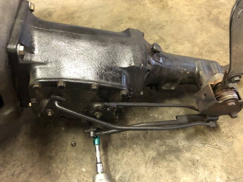

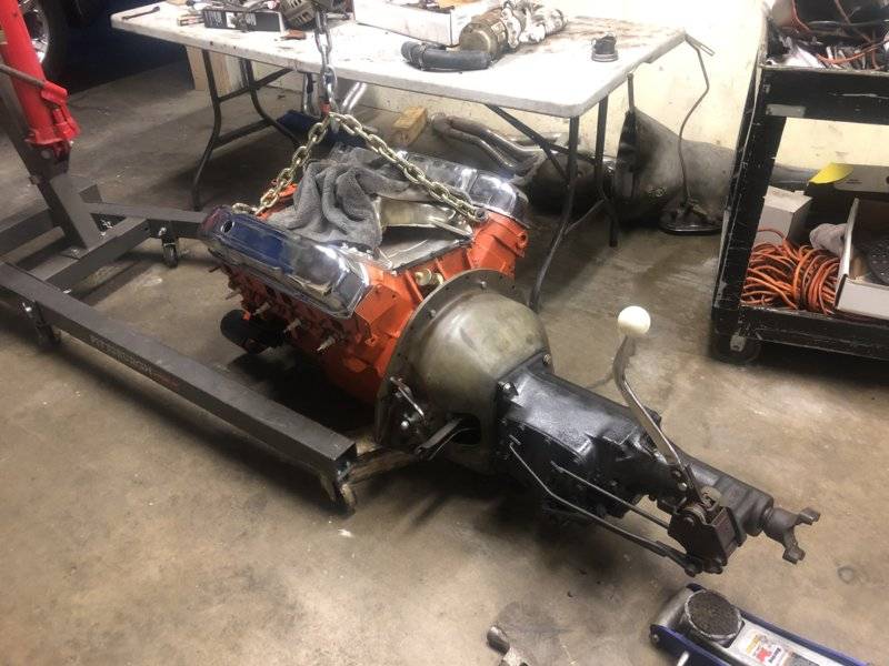

Hey guys I made a mistake. I bought this 4 speed trans ,for my 65 coronet, from a friend not realizing it wasn’t for a b body. The shifter location site right under the floor support. Does anyone know if I can change the tail shaft to a b body location or maybe does anyone have a b body trans for sale? Also does anyone know what trans this is? Again my car is a 1965 coronet

Looks like an A body trans. Not sure about the tailstock swap.
not without changing the main shaft in the trans. and even then most likey no. that's an A body trans..

Check with Dan Brewer Brewers Perf. He can identify it for you!
Does the front bearing retainer fit snugly in the bellhousing? Some of the A body trans had a smaller retainer.
