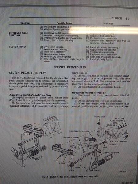

I mean you should make sure the clutch is disengage far enough when the pedal is depressed
Clutch pedal free play is how it is described in the FSM.

Sometimes a simple test in this regard is to simply push and hold the clutch pedal all of the way to the floor on this downshift to see if it improves a little. If so, a clutch adjustment will help.
If you are already pushing the clutch to the floor for shifts, skip the simple test and go right to clutch adjustment.

Checked linkage rods and shifter today. Nothing stood out. I pulled out my service manual time to read up on Clutch adjustment
